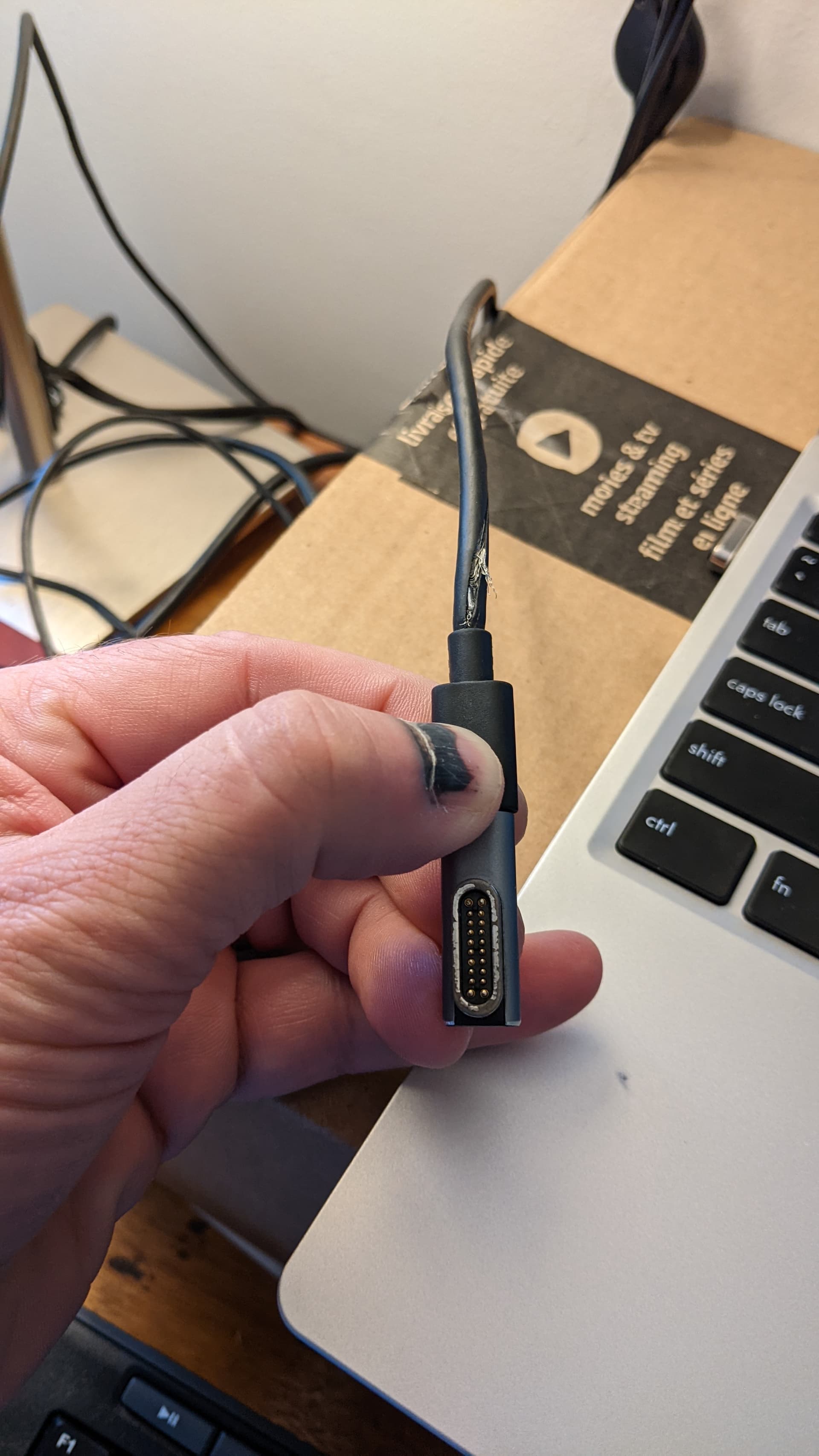

Writing a reply to report that I am now encountering the same problem. System is only 6 months old and I also have a longitudinal tear on the sleeve. May be a design flaw or quality control issue if there have been reports of similar wear patterns. The tear is also getting longer as time goes by.
I concede there is no official recourse for me as I’m in an unsupported country. Likely will also be cheaper to just replace the thing locally.

I had a similar pattern of breakage only 3 months into normal use. Pretty disappointing but after contacting support, they were pretty prompt about offering a replacement. I hope this issue gets addressed though, would be annoying to have to deal with this every few months
Anyone else have trouble with fraying charger cable ends? My friend wrapped up both ends of my charger cable with jute!
Note that folks who are seeing the cable fray after normal usage within the warranty period, you should reach out to Framework Support for a replacement cable. We’ve root caused this with our cable supplier and believe that there was a limited number of cables where molding of the sleeve wasn’t done at the optimal temperature. They’ve since adjusted the manufacturing process to resolve this.
It is still normal TPE-jacketed cable though, so over heavy use over time, there is risk of the jacket wearing at stress points. This is part of the reason we designed the USB-C cable to be detachable and replaceable. Much cheaper and less wasteful to replace a cable than a whole power adapter!
