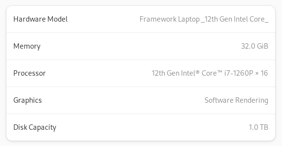

In Fedora (GNOME), the About page shows that I am using Software Rendering when it should say something about Mesa Intel Graphics.

My theory right now is that my integrated graphics are completely not responding, because only those distros that have fallbacks to software rendering work at all. Only thing is that I have no idea how that happens or how to fix it.
