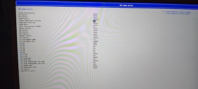

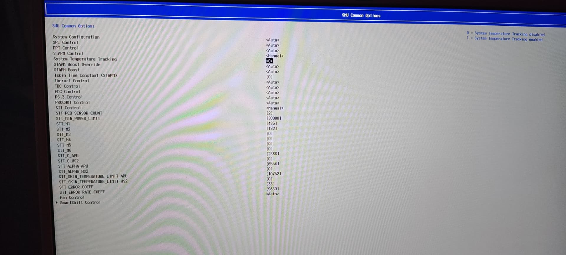

i had this issue too, i figured out yesterday that you can use smokeless_umaf to turn off that feature. On smokeless_umaf navigate to Device Manager → AMD_CBS_Hidden → SMU Common Options, set STAMP control to manual and then set System Temperature Tracking to 0.
PS: before trying to boot to smokeless_umaf you have to go to advanced secure boot options in bios and add each .efi file to the secure boot hashes, otherwise it wont work.
