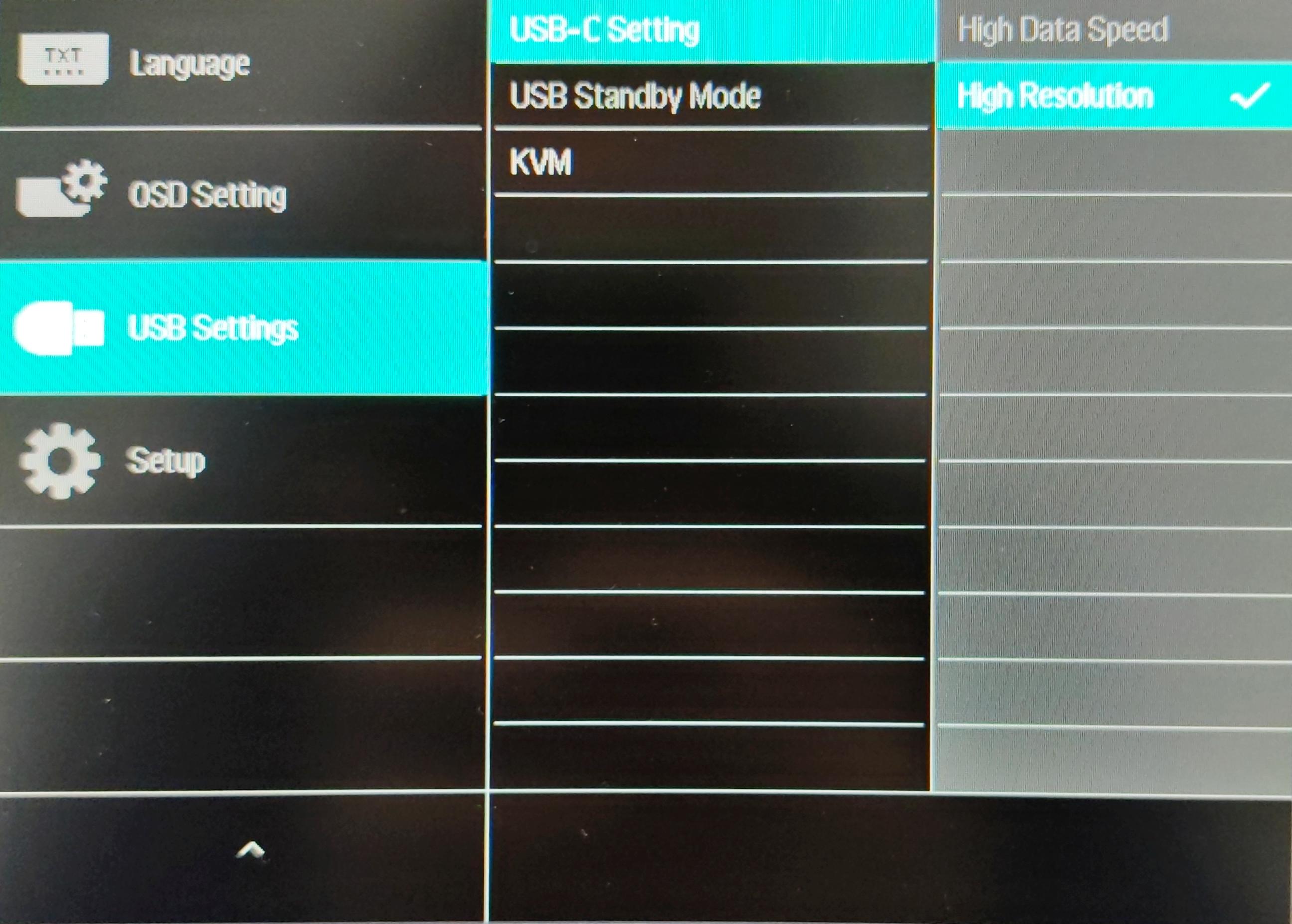

Is the monitor serving up more than just the display through USB? If so, this is likely why you’re seeing a bottleneck at 29.98 Hz. Speculating of course. But it looks like you may be.
Official support is going to be with devices we can control the outcomes for; HDMI or DP expansion cards. This is always the preferred recommendation.
Afaik since the internal USB hub is likely running with USB 3 it has to share it’s bandwidth with the display data, which causes this drop.
Could you check your device manual if you can limit the speed of the internal hub to USB 2 and if does any change?
@Anachron
You were absolutely right, thanks for the hint! I found a footnote in the manual about the refresh rate reduction to 30 Hz when using USB 3 in the German manual:
After switching from “High Data Speed” to “High Resolution” in the monitor’s OSD I am able to run the native resolution with 70 Hz :partying_face: , the only downside is the build in Ethernet adapter’s speed is now somewhere between 200 and 300 Mbits/sec :
@Caco awesome! Happy to help. Enjoy your crazy setup! :wink:
And thank you for catching that! USB 3, great catch!
