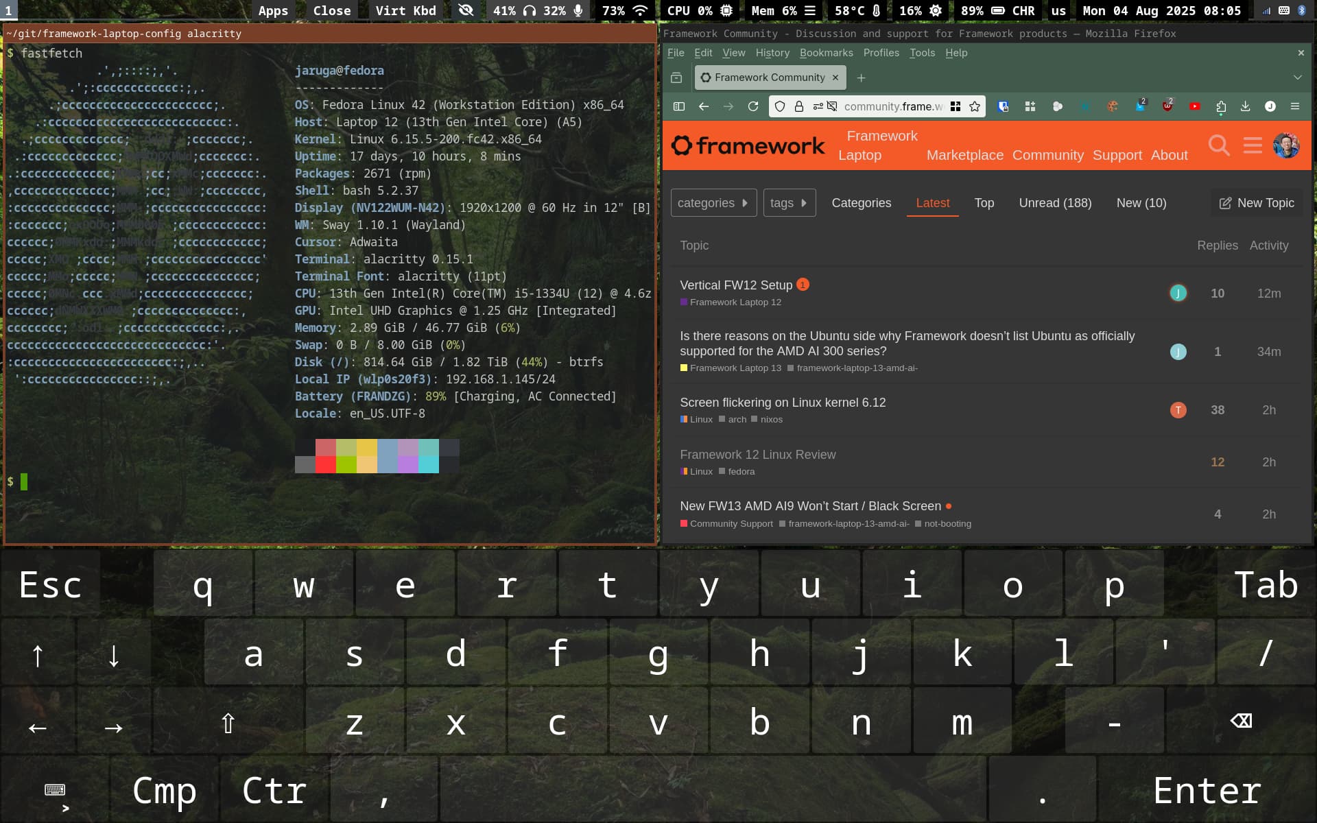

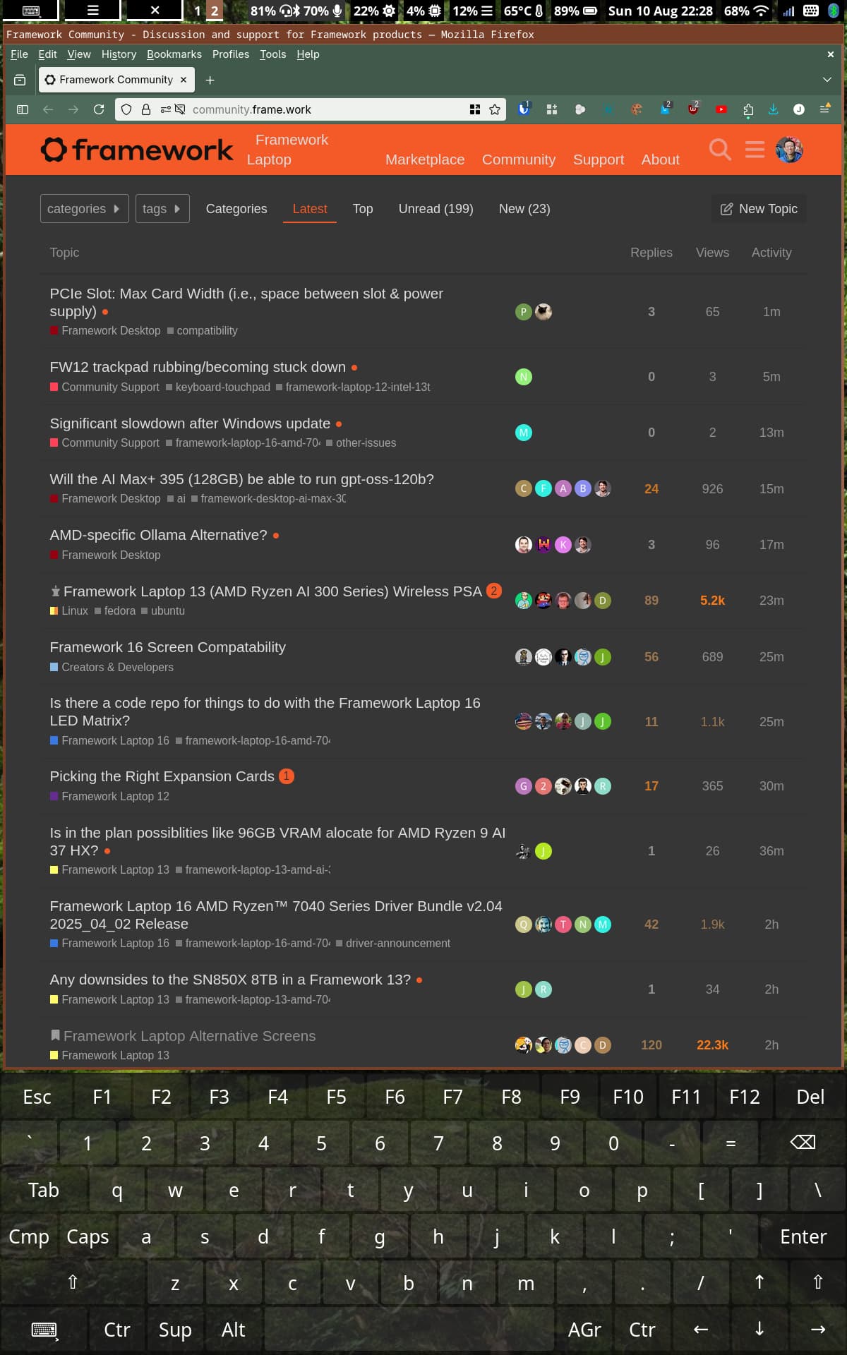

I recently commented, “I installed a virtual keyboard wvkbd. Then I need to set up the auto-rotation, and may add some buttons on Waybar.” on this thread. And here is an update. I customized the wvkbd, changing the keyboard size and font. I set up the auto-rotating display. I added the buttons “Apps” to toggle a menu to launch apps, “Close” to close the current focused window, and “Virt Kbd” to toggle a virtual keyboard.
You can check the details below.

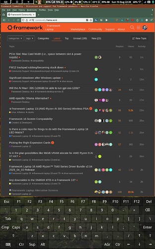

I updated the above screenshots with the transparent virtual keyboard.

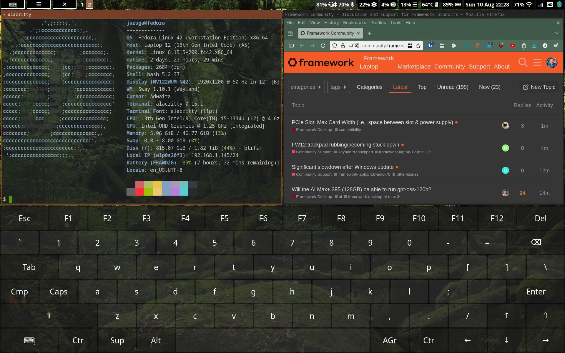

The above pull request was merged. Now Wvkbd (wvkbd-deskintl program) has a US International English-based full keyboard layout. I also added 3 buttons to toggle the virtual keyboard (wvkbd-deskintl), to launch apps, and to close the focused window on the Waybar at the top left. The screenshots are below.
Landscape
Portrait
