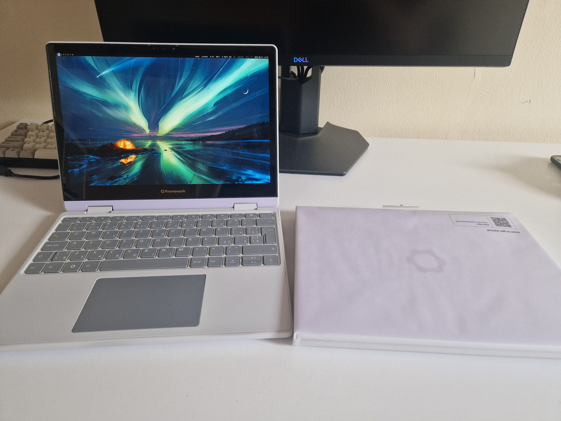

received a replacement laptop today, the cracked one is packaged and has a label on it but unfortunately i wasn’t able to drop it off today, it’ll have to wait till monday as no UPS places pick up parcels over the weekend :<
the new laptop is without any crack or mark on it, the trackpad is slightly misaligned in the same direction as the previous one, but not nearly as much so physical click works properly.
i assume they haven’t changed anything about the laptops yet while they’re investigating and therefore this one is also susceptible to developing those cracks, so i left the screws a little lose to see if that changes anything.
