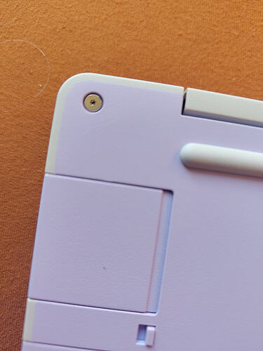

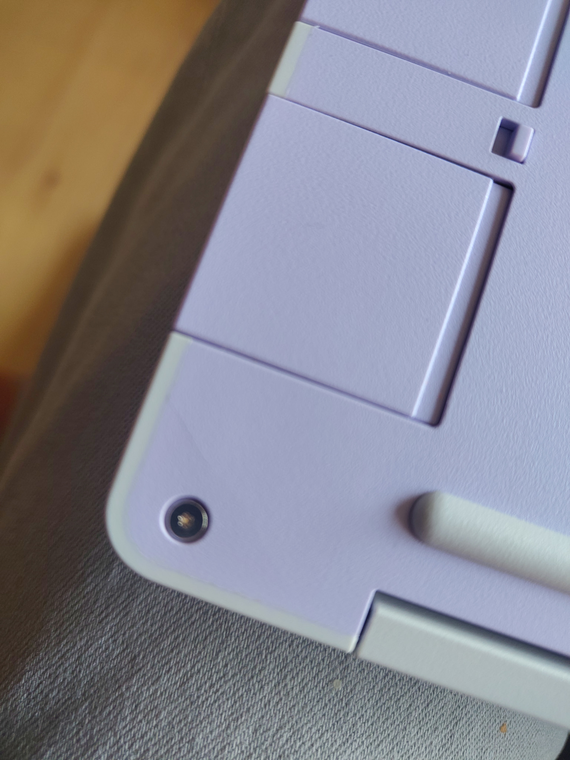

I’ve only had this thing since Thursday. There are now deformations that weren’t here when I got it…
Will keep monitoring this. If it gets worse, I’m afraid I’ll have to start bugging support.
Hello, I’m sorry to have to tell you this, but it already looks cracked.
I would recommend that, if you have the time, you contact support directly.
Just contacted support with the issue. Honestly pretty disappointed, I was really hoping they’d filtered the crack-prone cases out of new units by now. Might ask for a refund on the laptop hardware and re-use the SSD/RAM in a different device, given how prevalent this issue seems to be.
