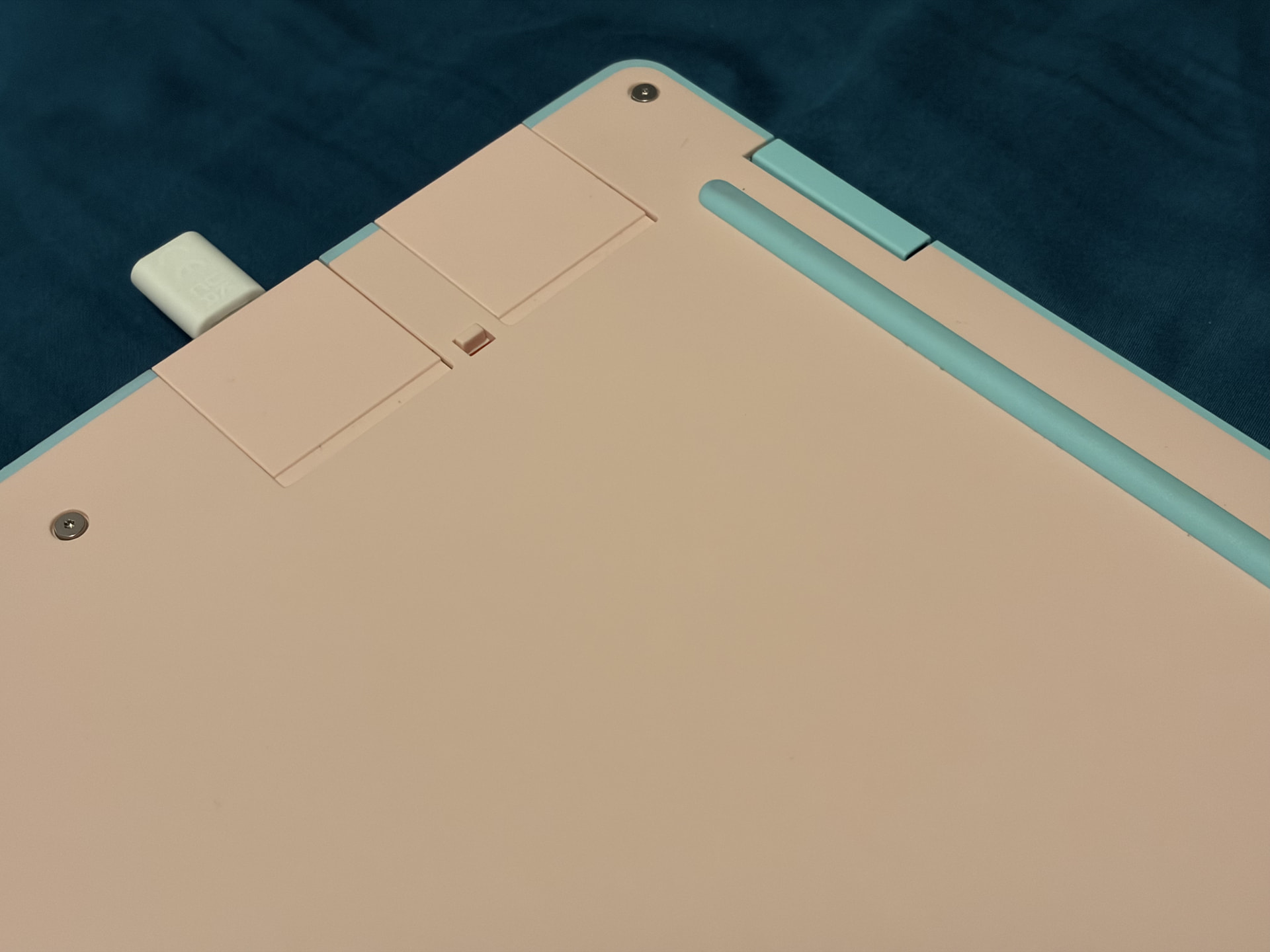

Hey y’all. Owner since September of 2025 (batch 10) and surprisingly my unit which I keep in my bag (which I toss around) a majority of the time STILL has no cracks. I tightened the screws only using the official screwdriver, never overtightened, and I exclusively use the Framework 12 as a laptop and never use the tablet mode.
I guess I won the lottery with Framework 12 devices? I keep checking every now and then for cracks and… nothing. Figure I just share my experience.

I got my lavender laptop about two weeks ago, and the usual stuff for this thread - surface cracks on bottom shell with mold date 31.11.25 and assembly in 12.25 :melting_face:

I’m glad you don’t have any cracks though. I think I’ve mostly seen Black, Grey, and Sage being effected by cracking issues.

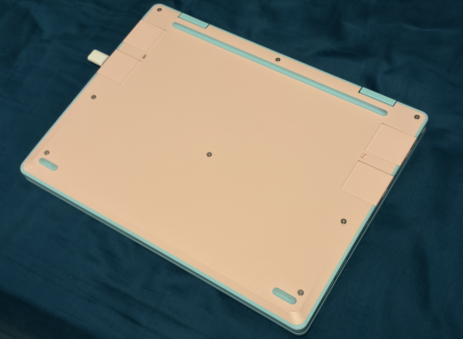

Just got finished replacing the bottom on my FW12, took pretty much 1 hour. Only real PITA was the antenna connectors :smiley: While kinda annoying dealing with defective product, the system worked as it should, total 5 business days from opening the ticket to having a replacement part at my door.
Nice job! Recommendation in this thread seems to be to not even disconnect those.
Even with that issue it’s great to at least have the option to repair it and that it’s so easy that even we ourselves can do it.

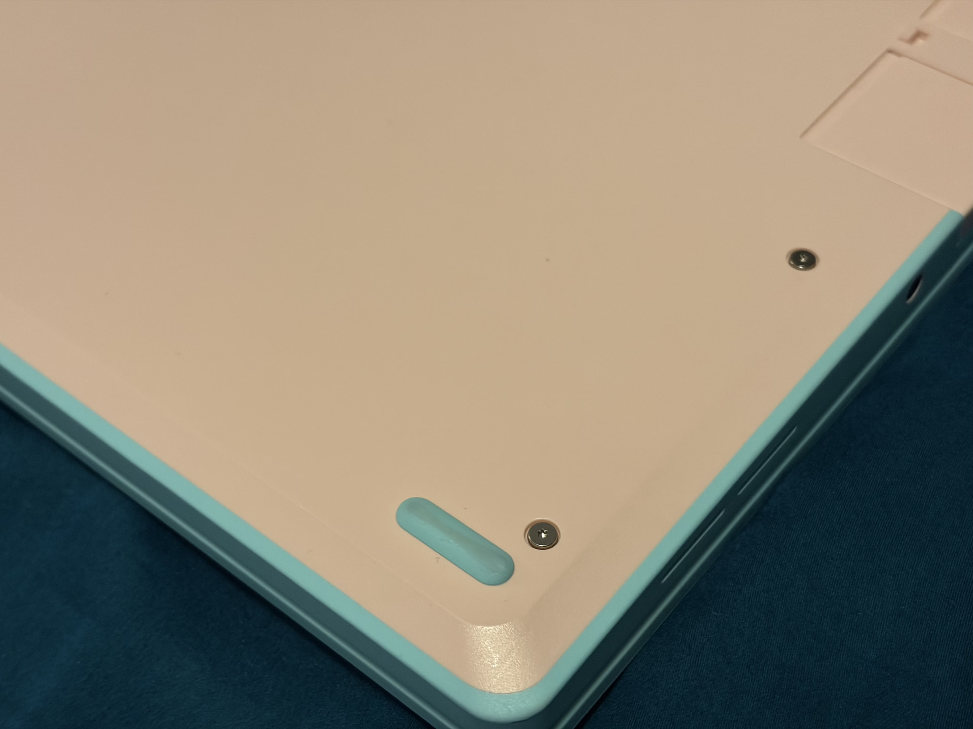

Bubblegum user here, unfortunately my original bottom and top cover cracked plus replacement bottom cover starts showing signs of cracking so I wouldn’t say that bubblegum is less prone to cracking
Lavender must have issues too, or maybe I’m horribly unlucky. I’m on my third bottom case, and fourth top case. This latest bottom case has finally held (despite having an older production date; don’t remember but think it was 04/25) but the top cases crack at the hinges within a few weeks, just from opening/closing (this latest top case has never left the house). I asked them to not send me a replacement until the issue is fixed. I imagine it’ll get worked out eventually; huge bummer though, lovely little laptop otherwise.
As a bubblegum user, I wish I could partake in this privilege lol
My latest bottom cover now has the same “dent” that usually is an omen for cracks. I assume it will happen, since it’s the same batch as my previous one.

I realized something must have physically changed, so when I had some free time I went to open the machine again and check the audio card, and when I flipped it over I got to discover this pretty sight:
Not the clearest picture, but that is a 4-5cm long crack from the bottom corner of that expansion slot towards the middle of the case.
I believe my audio issues may have been due to this bottom case crack issue the entire time. I’m guessing that the crack began from the inside around January (about 2-3months after receiving, and a similar time frame to what some others in this thread saw) which gave enough tolerance for the audio board pins to not fully engage when the case expands slightly during battery charging. My audio issue seemed to slowly get worse between January and mid March, which makes sense that the crack was expanding during that time. When it suddenly got significantly worse I’m guessing that the fatigue of the already damaged case allowed the crack damage to accelerate. I definitely had an “oh crap” moment when I flipped the machine over the other day and saw what happened, but it makes sense that the crack is the culprit since you can restore speaker function by gently squeezing the case together in the cracked area.
I just opened a support request, and am hopeful to get one of the post “2025 week 50” replacements, but I figured since no one else had mentioned the audio issue that it might be useful to relay here in case it helps someone else.
