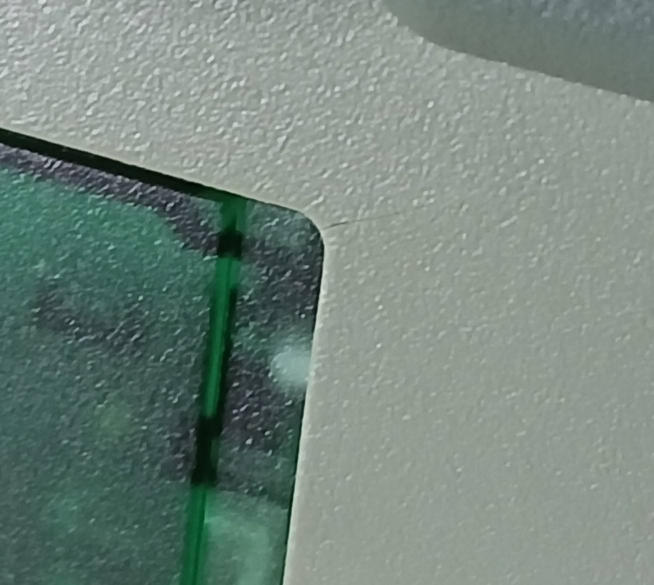

I noticed yesterday that my bottom cover has developed stress lines around the expansion cards again. This one is stamped for April of last year. So I guess I’ll be opening another ticket in a week or so when they open into cracks.
Never mind, it’s already cracked.

Would like to add mine to the gallery. One in the bottom-cover and a small one on the top-cover.
edit: created my first support-ticket…

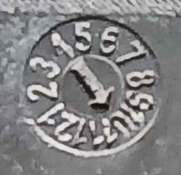

Here’s my date stamps on the inside of my 12.
I’m actually not even sure when it was manufactured because the arrow seems to be pointing between the 10 and the 11. It’s not just me right?
Also just noticed the sticker says 10 on it. But I’m not sure if that’s relevant.
Arrow seems to be pointing more at 10 than 11 in my opinion but its crowded and could technically be either.
From what I understand from previous conversations with Eagle the stamps are pretty useless (in terms of main info we are interested in) and are just indicating the molds that are used. Also stickers inside. AFAIK it’s all about the sticker on the outside of the packaging box. Which is fine normally, but a bit of a pain in the current situation.

Mold numbers are really misleading for our specific case. AFAIK they indicate the date when the molds themselves were manufactured and have no connection to actual cover manufacturing date or material. Curiously there was another sticker with another date (pre week 50/2025) inside the replacement cover which also had nothing to do with the bottom cover manufacturing date. If I understand correctly only the packaging sticker is the only source of truth. Not ideal in our situation but over time - once hopefully most covers are replaced in the future - it won’t matter any more anyway.
