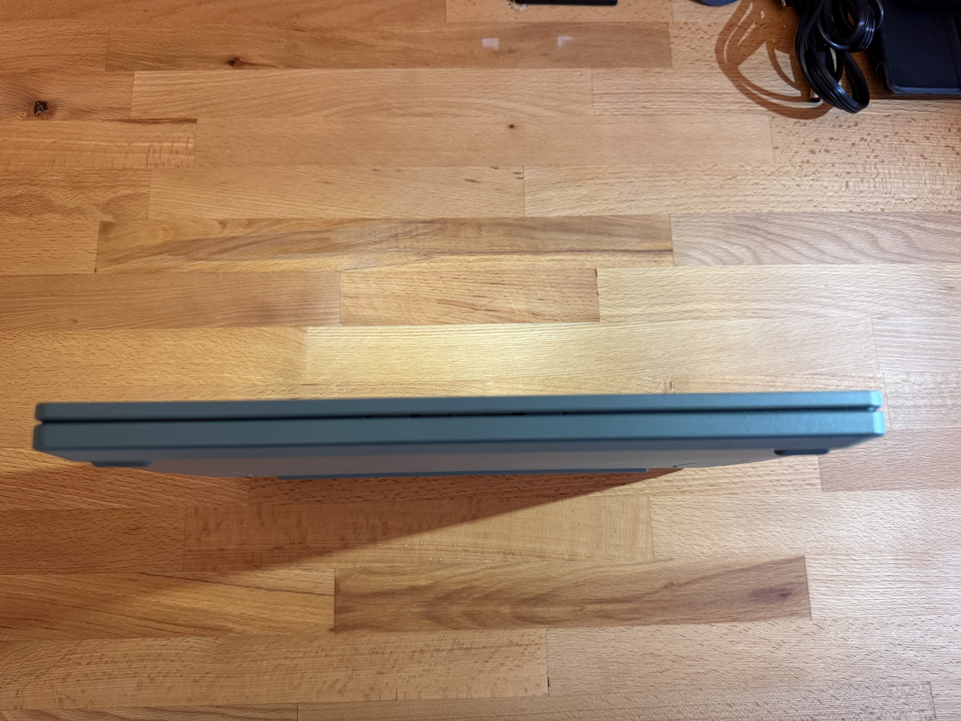

The replacement cover I got for my initial Framework Laptop also started cracking. That is the first attached image.
Support already sent over yet another cover (2nd replacement, 3rd overall cover) and before installing anything in to the chassis, I did a quick fitment test with the keyboard to see if everything lined up.
I’m no material engineer, but I DID notice that the edges where the keyboard screws in to the chassis were not flush with the rest of the chassis. I almost have to wonder if this is more of a keyboard fitment issue instead of a case fitment issue, since that’s what it’s screwing up in to, and causing all of the extra stress.
I’m absolutely certain the engineers over at Framework are trying their best to sort this issue out to the best of their abilities, but it is still frustrating to get replacement parts that fail very quickly. On my most recent case, I screwed it in so the keyboard becomes just baaaarely flush with the outer-rim of the chassis. I’m going to flip my lid if this one develops cracks somehow, too.

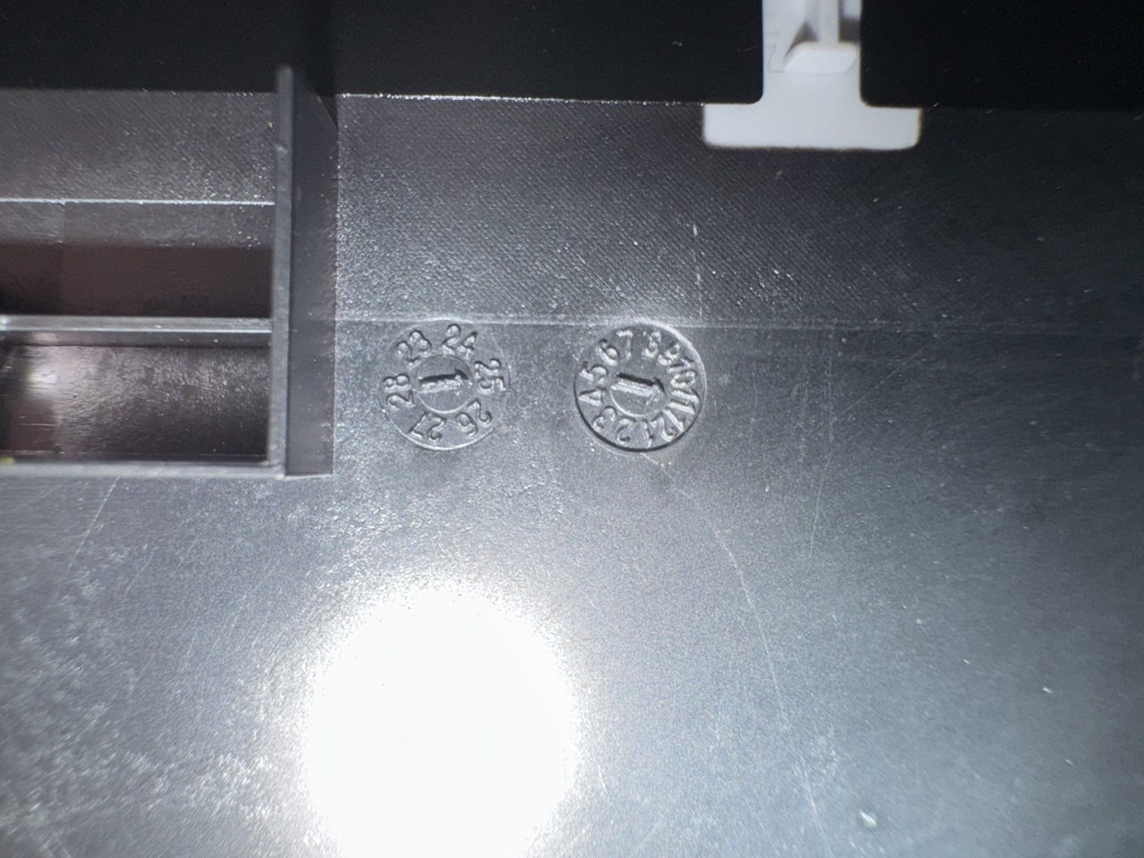

Lastly, I compared my first replacement chassis to my second replacement chassis. They’re both marked with the manufacture date of 25/11, so in theory these are the ones that have been re-engineered to not have the cracking problems. But I don’t have a ton of faith at this time.

Thanks for your insights. AFAIK they never confirmed fix dates for all colors but only one global manufacturing date from which they deemed all the different chassis colorways (at least bottom cover) fixed. That was week 50/2025. The molding stamp you mention is before that and also does not really say much, since only the sticker on the shipping box of the replacement covers are the correct date. I got a replacement cover bottom cover (don’t remember RN, but I think #4 total including initial laptop) that had a week 10/2026 sticker but also a modling stamp from 2025. It’s the first bottom cover that is holding up fine after several weeks and on two trips. Not 100% sure but someone mentioned a post Jan 2026 cover cracking too though, so it might be just delayed.
Just wanted to give some more context to the date you mentioned.

@BigT Thank you for that clarification! Also, I want to thank @Anthracite & @wolfie for their last comments about the cracking. I took some additional photos for support today. During that process I removed the battery which reveals the manufacturer dates. I think the replacement laptop I received back in January was manufactured in October of 2025 and the stamp on the bottom chassis is 25/10, so if I am understanding correctly the unit I received is before the global fix date. If someone want to confirm that I would appreciate it.
The replacement bottom cover on the box for me says 07/2026. Hopefully no issues with mine.
Similar here, the 1st replacement (that also developed cracks and Framework wanted me to ship it back them) and 2nd replacement have the same manufacturing date 2025.11.15 and 25/11 stamped into the chassis. I suspect those are bottom covers after the manufacturing fix and Framework team wants to investigate those.
