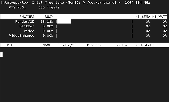

INTEL_GPU_BOOST_FREQ_ON_BAT=650 (not worth it likely, GPU scales on it’s own very well see “intel_gpu_top”)

INTEL_GPU_MAX_FREQ_ON_BAT=650
Limits the iGPU clock to 650 mhz on battery power, the lower bound setting (INTEL_GPU_MIN_FREQ_ON_BAT=100) doesn’t seem to do anything really. IMO this is only helpful if you will be loading the gpu fully but don’t want it to go to max clocks, in regular use I find that it does a fine job of clocking up and down to just what is needed. You can use intel_gpu_top to see and decide.
