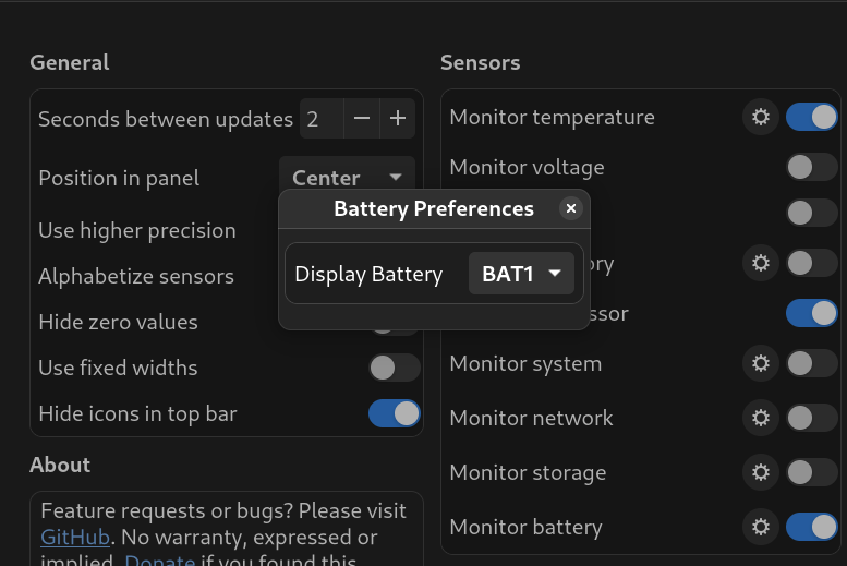

Sorry for the late reply, you might need to select “BAT1” in the config though I don’t recall needing to set it.

What app is this?
