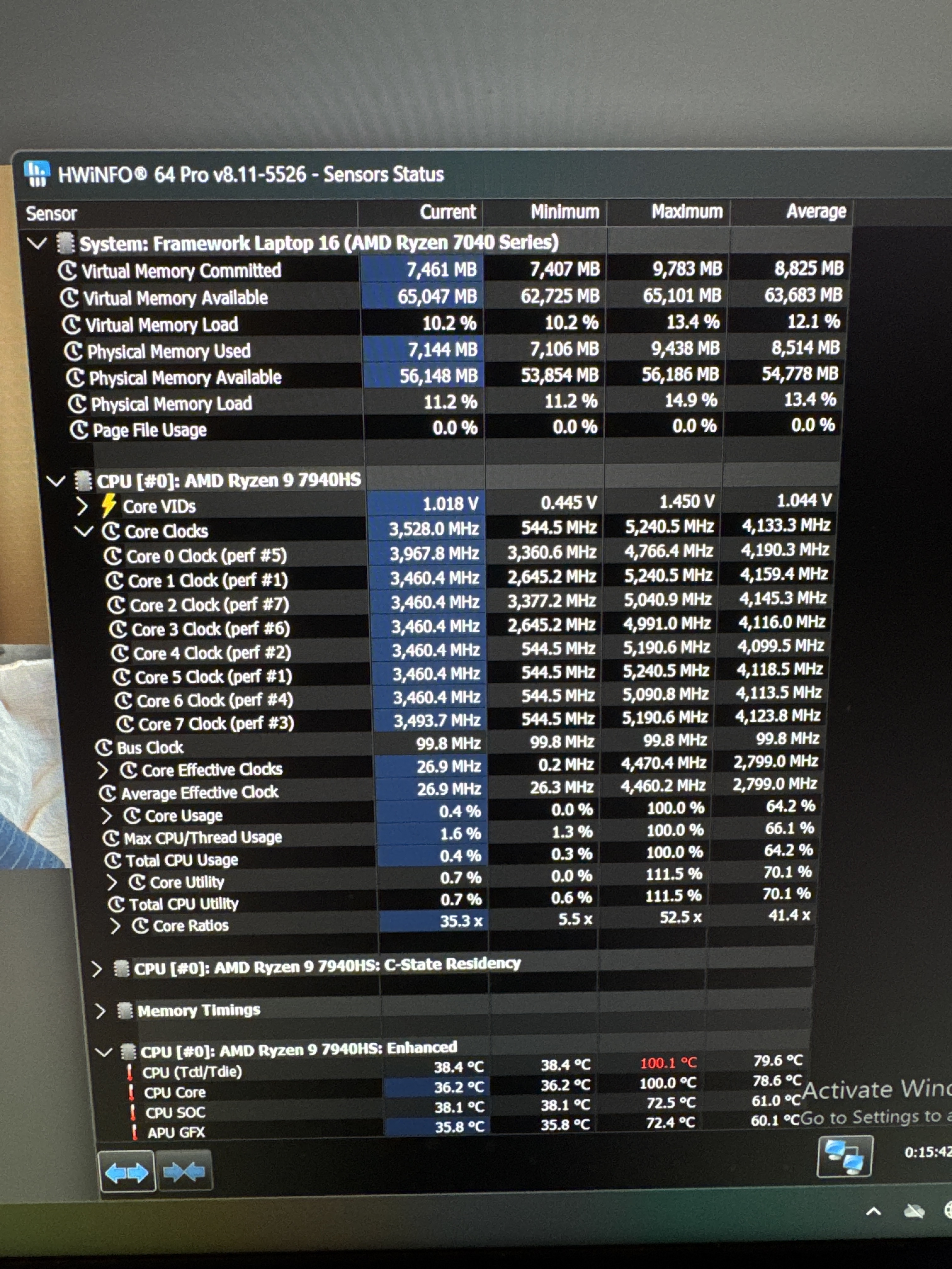

Hello everyone! It’s been a bit over two weeks since I last gave an update regarding my system’s performance.
I last updated you all letting you know I replaced the CPU’s Liquid Metal and that I had lapped the heatsink. As of now, my CPU is still getting great performance with significantly less fan noise.
Below are the temperatures and power during a cold-boot cinebench R23 run. I have windows 11 24H2 (Build 26100.2033) with the framework driver pack installed.
I ended up scoring 16471 with the modification I did, and it has consistently been scoring similarly across my periodic testing.
I am using the Delta 240W charger and a DGPU in my laptop.
As far as core clocks go, each one has been boosting well, but I would like to get some input from others if their CPUs are all the same regarding the hardware-fused order numbers.
As you can see in the screenshot above, Core 5 and Core 1 are the preferred cores in my system. In my desktop computer’s configuration, these preferred cores are the ones that run hotter overall and can be harder to undervolt due to the power/performance curve used by the cpu.
Have others been able to get their pref #1 cores undervolted significantly using software? Does anyone have cores other than 5 and 1 as the pref cores?
