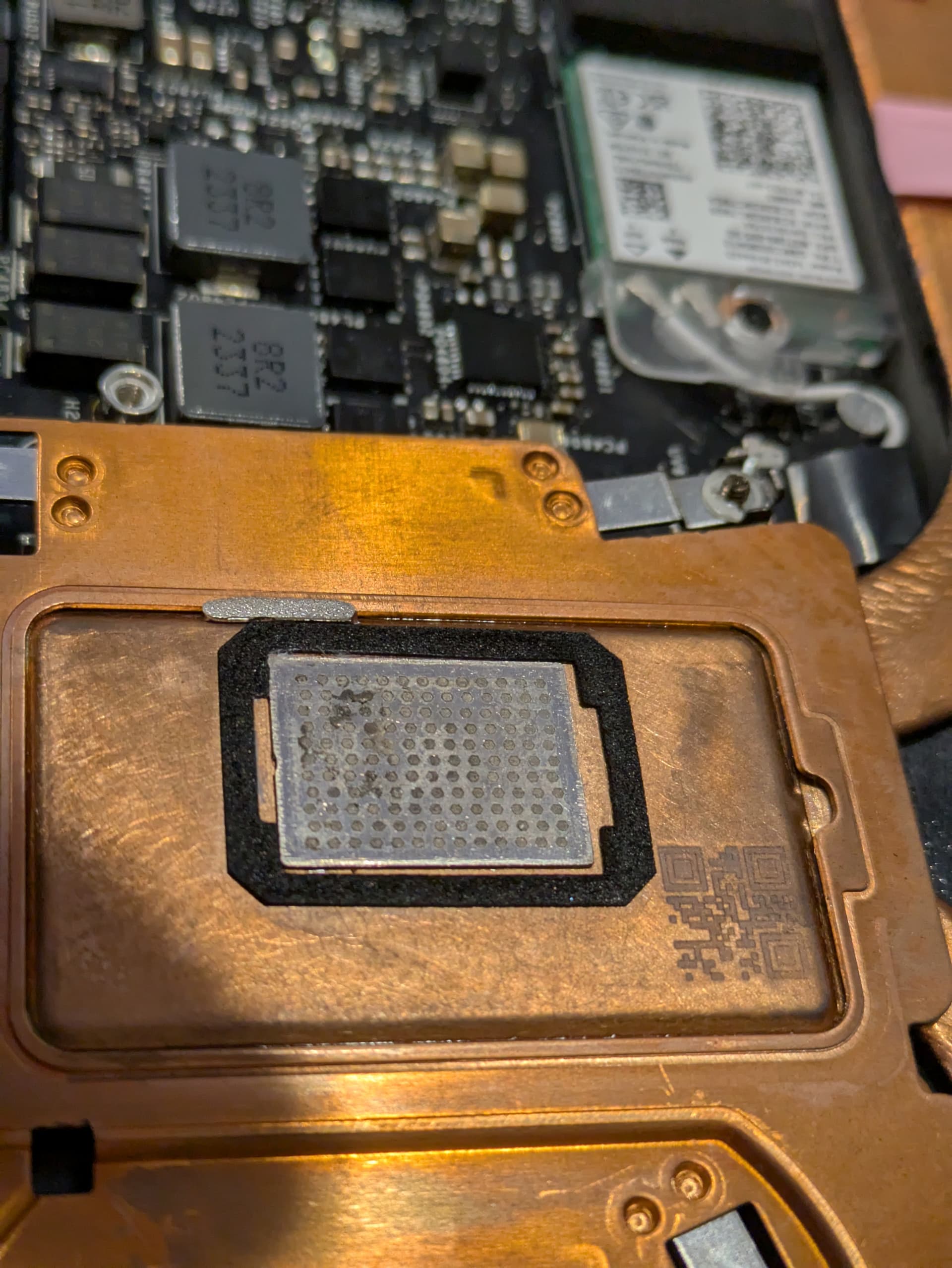

Add to this - here are the pics of the LM after removal of the heat sink - of note was the piece that was completely outside the “pad” area
