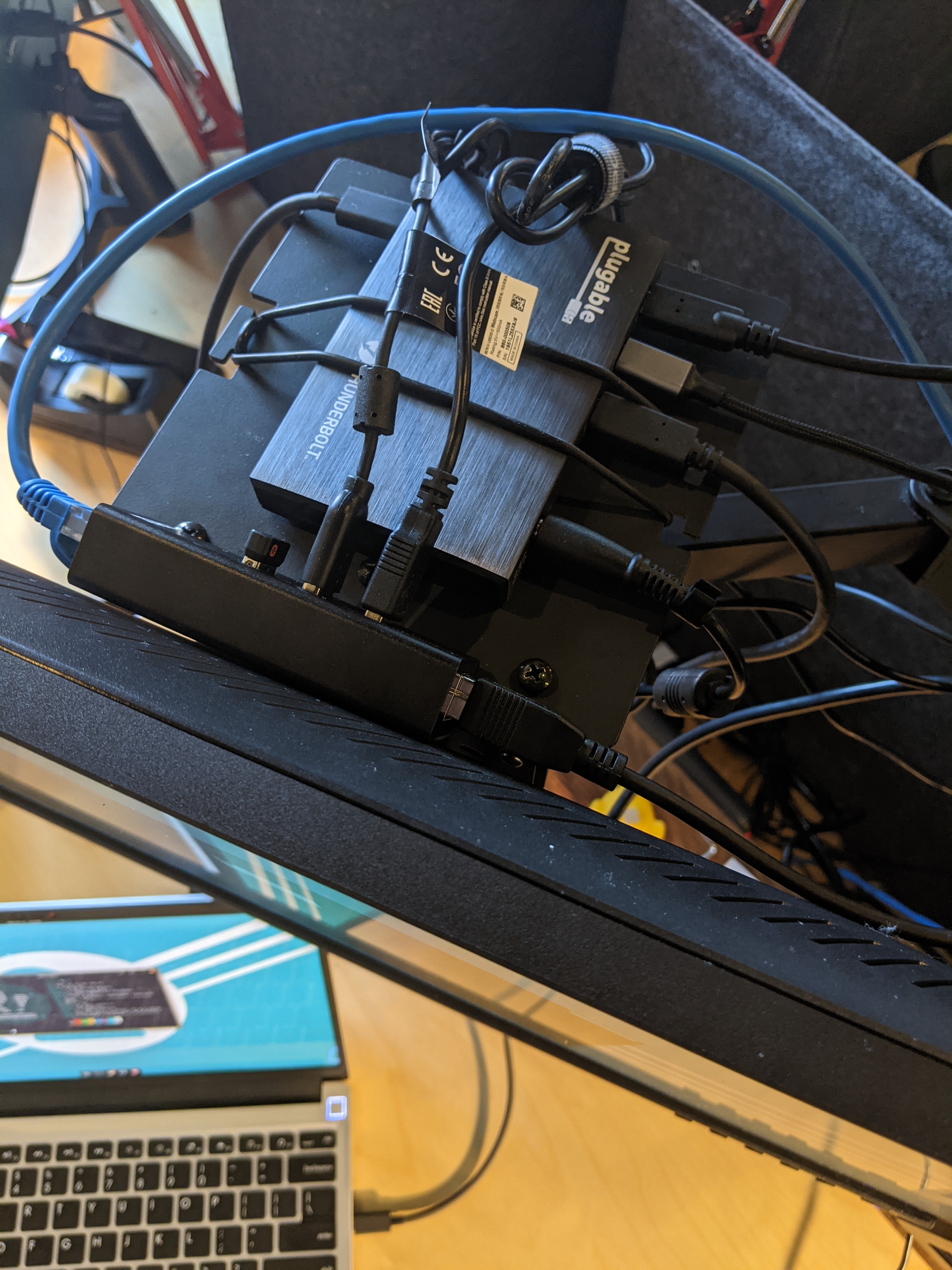

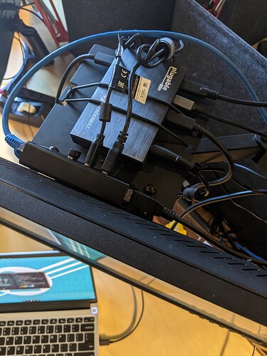

Just got my batch 4 framework in last week and want to share my setup. I’ve only used this setup for a day or two but it seems like it is going to work well! Note I’ve only tested this with PopOS.
TL;DR: with just a single thunderbolt cable I’m charging the framework, getting ethernet + 3 USB A ports, connecting to a 2K monitor (usb c) and a 4k monitor (hdmi)! All for < $250! This will be so great when moving around the coworking space I’m at.
So while researching all the thunderbolt dock options I came across https://plugable.com/ and eventually their thunderbolt 4 hub: Plugable Thunderbolt 4 and USB4 Hub – Plugable Technologies
Notably they don’t have a thunderbolt 4 “dock” - instead, they have this hub that serves as the base to build out a more custom dock. The hub itself supports 60W PD and comes with a USB C → HDMI adapter! I think they could advertise this better, I didn’t realize how this worked until I watched the video: https://www.youtube.com/watch?v=78DSaw28bSU
I paired the hub with this combo ethernet + 3 port USB A adapter: Plugable USB 3.0 3-Port Bus Powered Hub with Gigabit Ethernet – Plugable Technologies
Ethernet and USB has been super solid but I’ve had a little trouble with the 4k monitor (but this is likely software not hardware/thunderbolt related). Sometimes I’ve had to power cycle the 4k monitor before it displays anything, the display is detected but just won’t show anything. I also had issues using the 2 displays while fractional scaling was turned on but I’m fine using the native resolution so it isn’t a prob for me!
