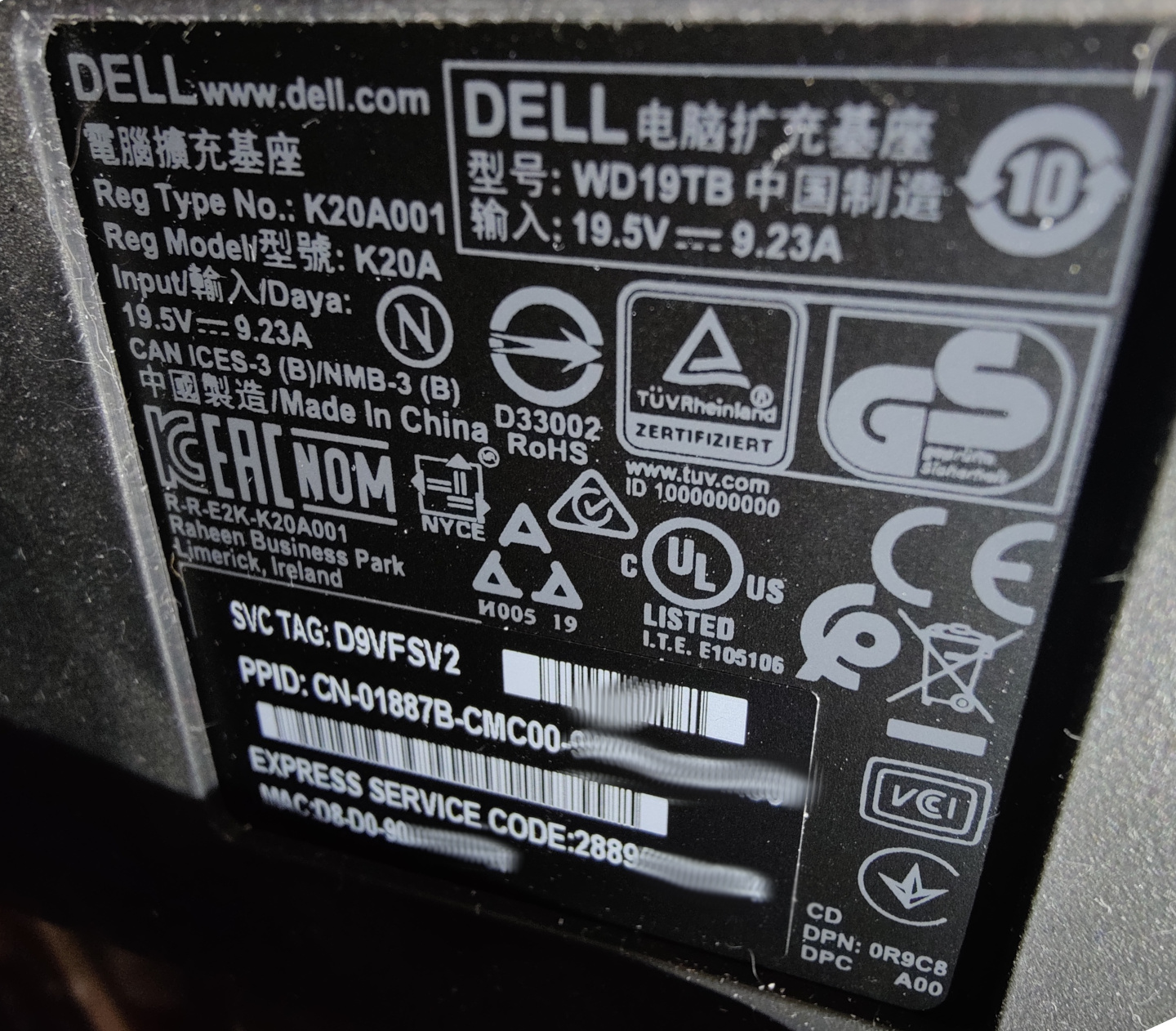

I can confirm the Framework laptop (Fifth batch) works well with the Dell hub monitor and secondary external monitor.
Dell WD19TB - Windows 11 - Triple monitor working at 1920x1080 60hz, 2x DP to HDMI, 1x HDMI.
Ethernet working through dock
Audio working through dock
Only cable plugged into the Framework laptop is the dock itself.
All dell firmware and drivers installed.
A recommendation: If it’s working for you, don’t update the firmware. Ever.
Firmware “upgrades” to TB16 made mine go from working OK to having all kind of problems.
I used to love my Dell XPS 13 + TB16 combination back then, but Framework + Anker blows it out of the water.
Regarding Dell dock WD19TB, I’ve had zero issues with it on Manjaro. power/charging works, display port + HDMI output (with audio) works. I’ve not tried upgrading firmware with fwupd.
Any specific tests someone wants me to run?
Does the power button (on the dock) work? (i.e. can it turn on the laptop from totally off, sleep, etc)
@Carlos_Fernandez_San i also have the wd19tb and the power button does NOT seem to do anything with the laptop. That being said there is a bios to power on when ac plugged in and I wonder if that would work.
