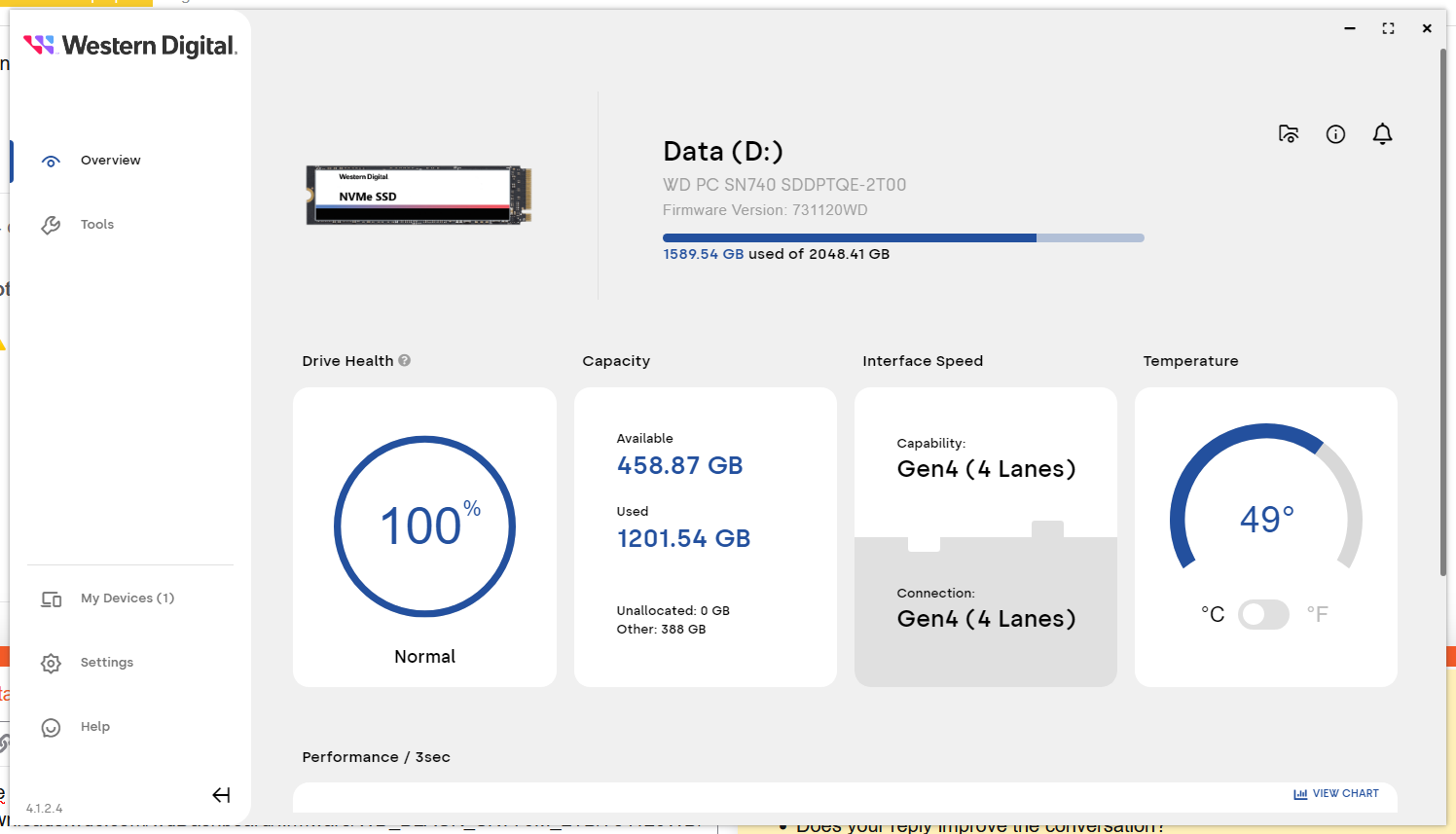

Thank you for the FW guide, successfully upgraded my SN740 2TB FW by a SN770M one.
So far no issues switching from 73110000 to 731120WD
Hope now my dell would stop freezing after deep sleep
