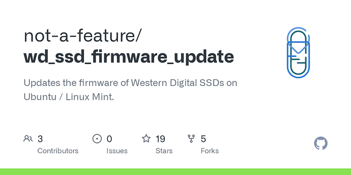

deleted my fork, changes now incorporated into original script
Thanks to you and @not_a_feature the script worked beautifully.

I’ve add the requirements checks and converted the gist into a proper repository.

:warning: News: Use the interactive tool wd-fw-update.

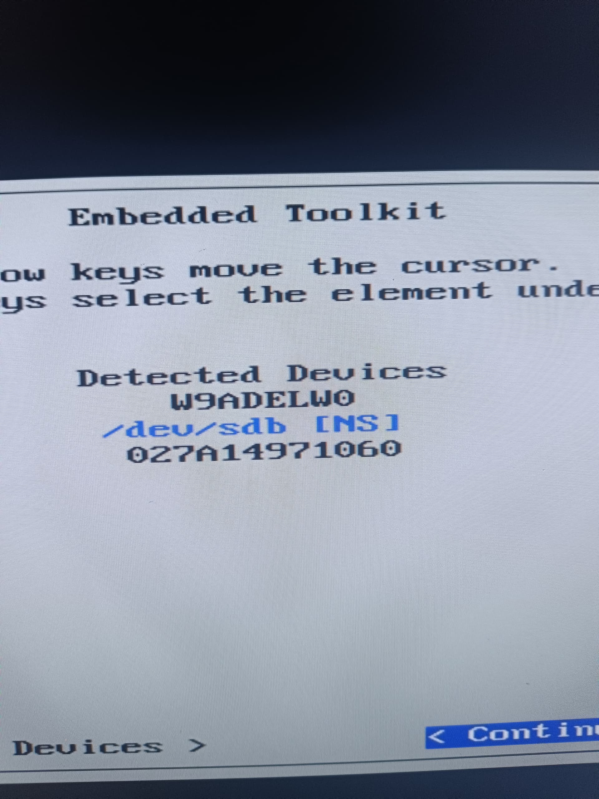

The problem is like here with the WD Green 120Gb.
I faced with this kind of problem when I tried to know what my model is:
I am not able to see it!
But I searched the model name in the internet, found it in the list you attached and download the proper firmware update file. Then I follow the instructions and faced with another problem. When I need to choose the proper drive, I see this:
(blue one is proper).
And then I tried to update, but receive this error message β€œFirmware Download Failed”.
Then I found out that this drive may be a USB flash drive with the firmware. This means that this toolkit doesn’t see my SSD. But I can see it in the BIOS and in the Disk manager in Windows.
What do you think it can be?
I’d appreciate itπŸ™
In the windows physical disk listing, notice that the serial number of your SSD is shown (W9ADELW0) and this is also shown in the updater you boot from the USB device. So, the updater does see the SSD.
Why it fails to load the firmware onto the device, I do not know, sorry.
That one is HDD, but thanks
