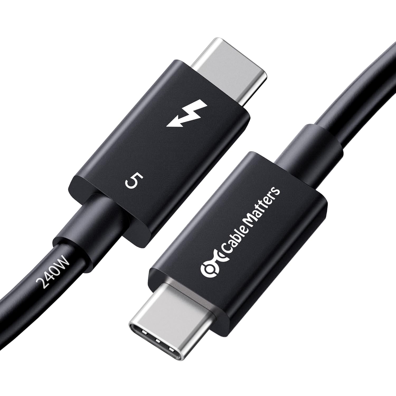

I am rather lucky since I work at a place that has TONS of old caldigit docs. I use the 3 foot cable from caldigit. I suspect if you have any old tb3 (not sure about this) from apple the might work too. DO NOT use a charging cable, or the generic ones. The important thing is to see the “thunderbolt’ bolt and have something reasonable (intel certified). Please note that I haven’t actually done this yet! Here is a product google recommended (based upon a query I did). I suspect a search on ebay for old active tb4 (not sure about tb3!) or tb4 might be worth a try if you are strapped for cash (which I suspect you probably arent since you have a framework!). The logo is the most important thing, it means its certified (keep it short too, long=instability). People forget that 40gbps is a PCIE interface in a cable!

Thanks! Pfiu, so now we’re looking at an activa thunderbolt cable. I found the: Cable Matters [Intel Certified] 40Gbps Thunderbolt 4 Cable 0.3 m with 8K Video and 240 W Charging which is intel certified.

@entropy4936 thanks man, I’ll get that one.

Thank! I just bought a TB4 usbc cable from cablematters. WIll test and report back
