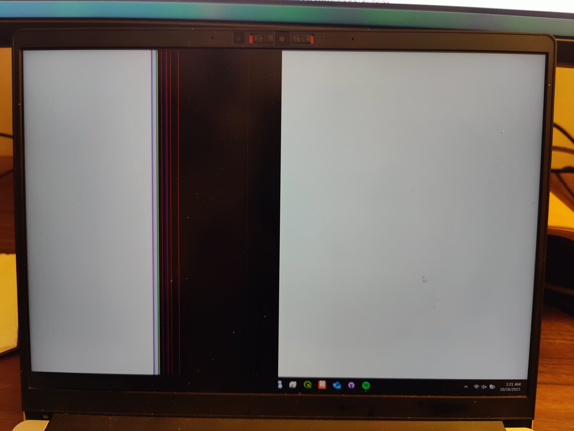

I am posting this in the hope that someone finds this post useful. I have a framework 13 AMD series laptop for a little over a year. Over the last two days I found that my screen has a huge vertical bar right across the screen. It was sudden and I found that I wasn’t the only one and this has happened before. When I first bought Framework laptop I was inspired by the experience of many who did not want locked in ecosystems and laptops and desktops that cannot be repaired. I came from a place when repairing hardware was part of the ethos surrounding good technology. To say I am disappointed how Support handled it would be an understatement. For a company that wants to make this repairable shouldn’t mean you need to repair everything once every year. Also as a new user I could only post 2 pictures

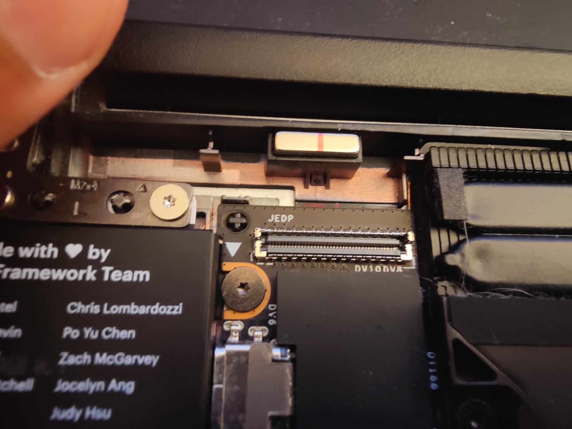

I reached out to support who made me send a magnitude of pictures based on their requirements like this one and ran it through a gamut of test and trials they wanted me to do. Note that I had already mentioned to them that my laptop was slightly over a year old. After going all this I was told to reset my “mainboard” which by the way is confusing at best especially the instructions were not clear. After back and forth on this and with them escalating the ticket here is the final response. A pretty cold hey we think the product we gave you just a year back is fault here is a link to buy another one just in case our website is hard to navigate lets give you a link.

Usually, the issue you’re seeing is caused by physical damage either to the display cable, the traces at the bottom of the panel, or the panel itself. Support may cover it under warranty if it is still within that period and they can’t be sure it was customer-induced damage, but the reality is that it’s usually caused by closing the laptop on something or otherwise by an impact to the display. This is among the most common failures in any laptop. The good news is that, because you bought a Framework, you’re able to fix it, unlike most manufaturers who glue on the bezel or don’t make parts available.

Damage of this kind is often caused by the user. I can’t say for sure whether that happened here without having the device in my hands, but it is the most common cause of this failure. However, that question is not material when the warranty is expired. You have had the laptop for a year, so you no longer are entitled to warranty service.
