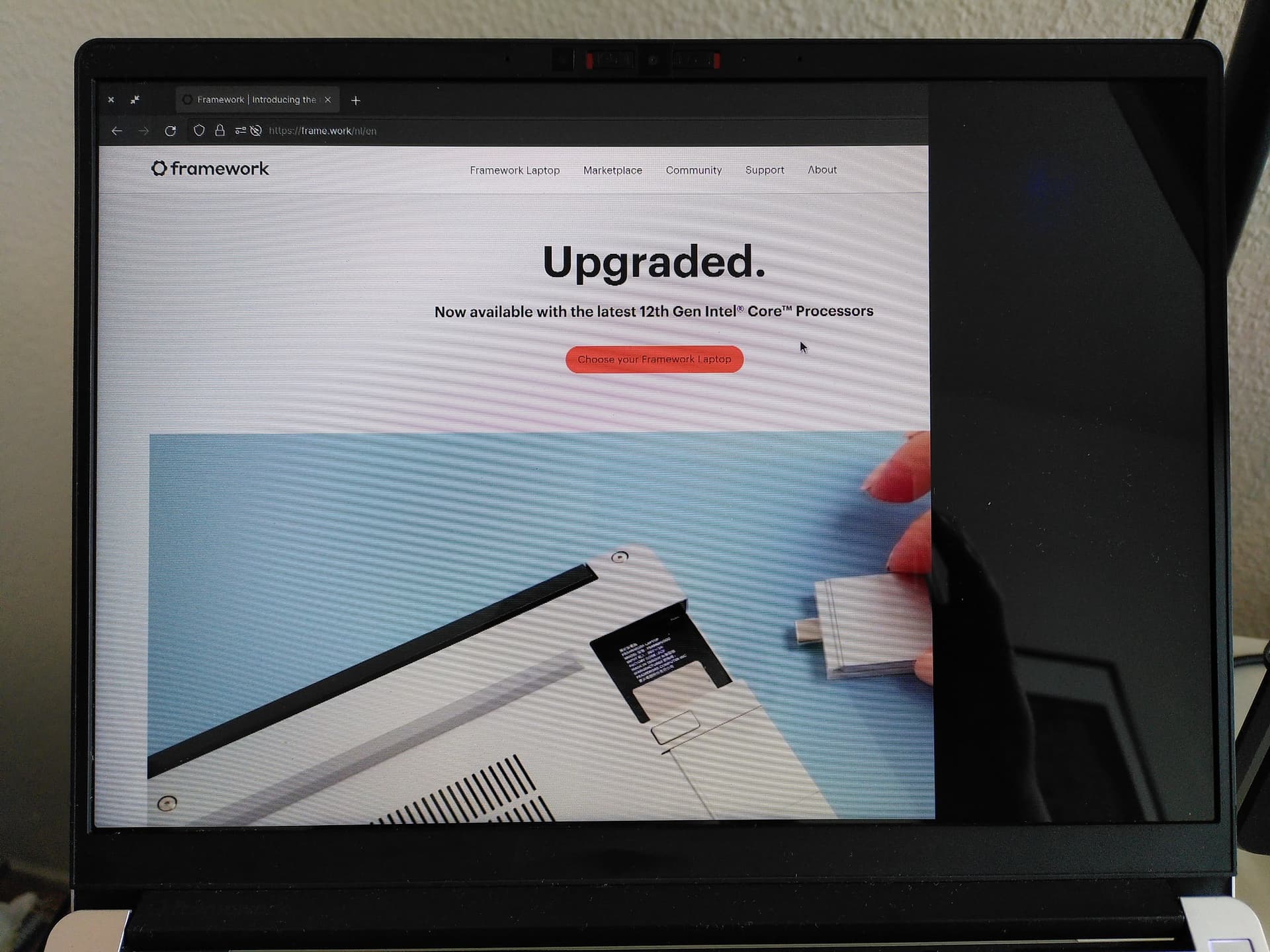

The symptoms changed over time. The left side showed weird artifacts and now seems to have a horizontal black line every other line. The right side is now almost completely black except for some subtle dark blue lines.

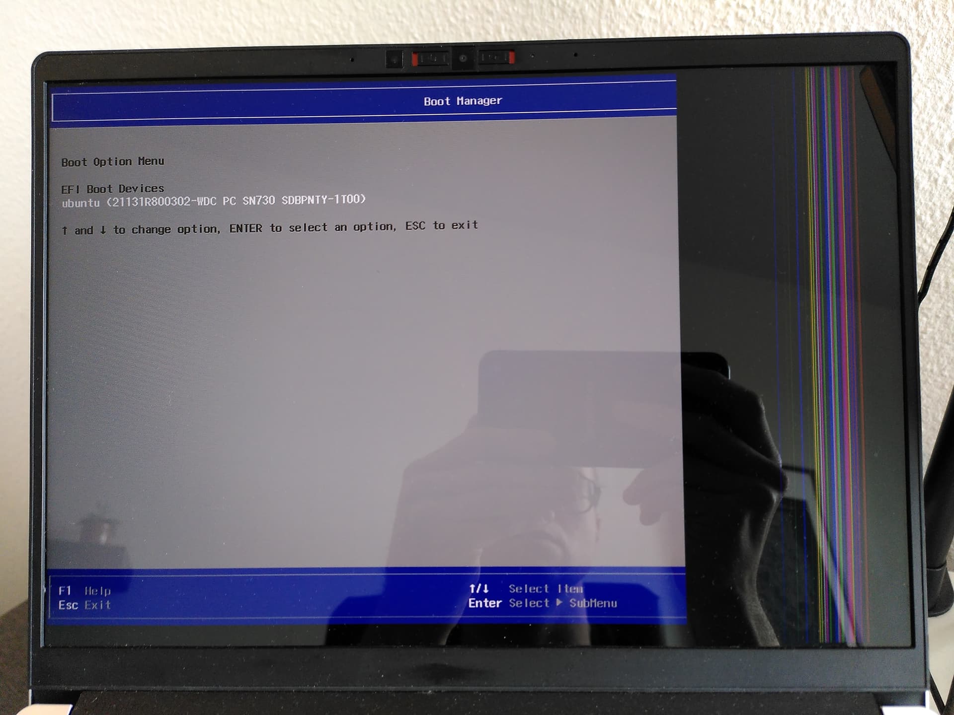

The issue is also visible in the grub screen and a restart didn’t help so I’m pretty sure it’s a hardware issue.

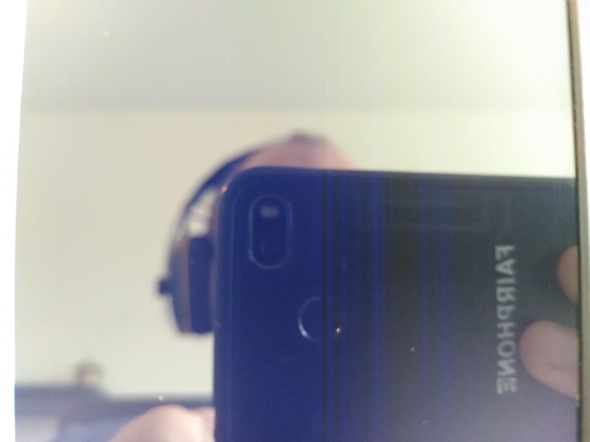

Earlier artifacts on left side:
Horizontal black line every other line on left side:
Subtle blue lines in right side:

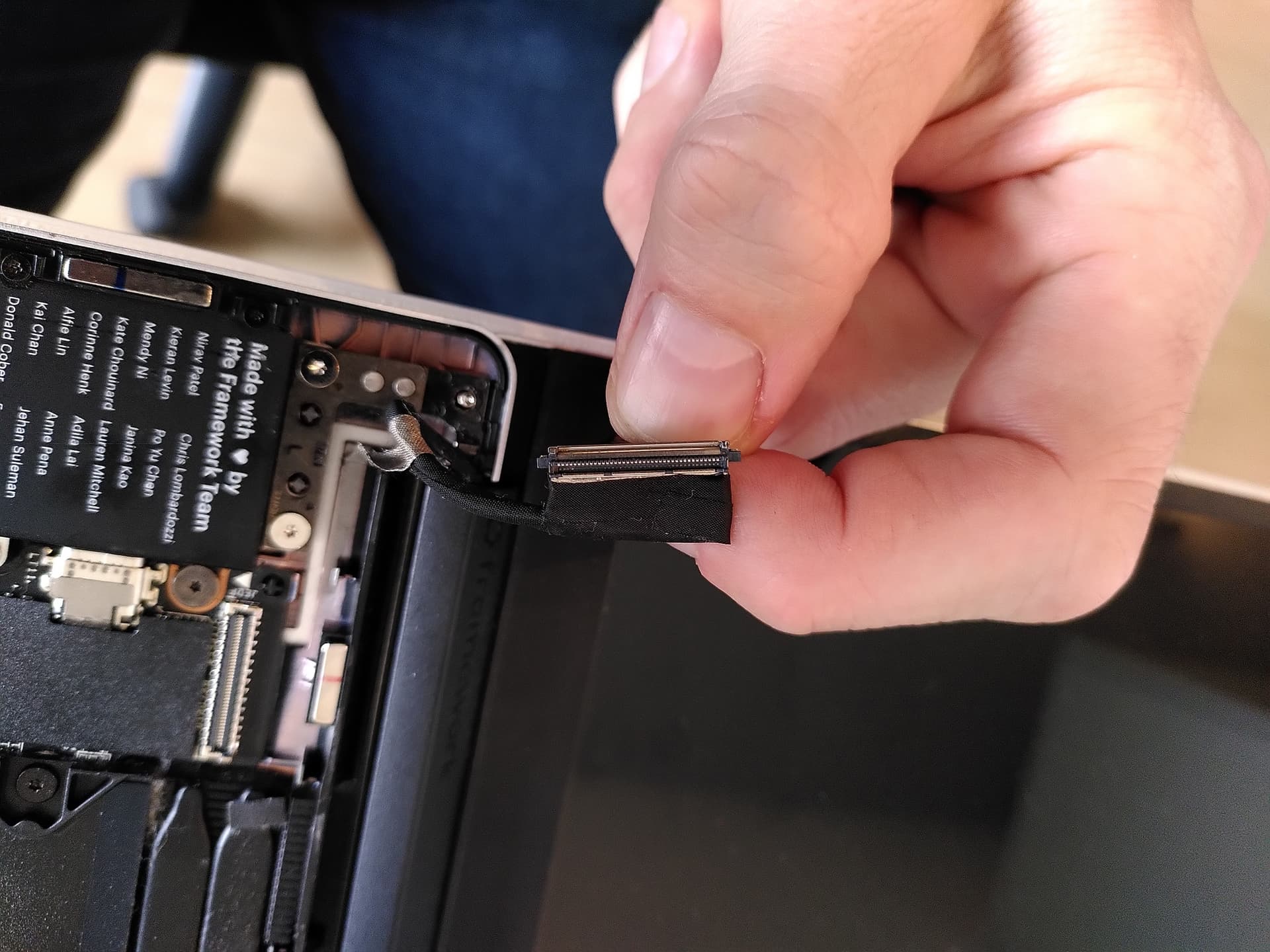

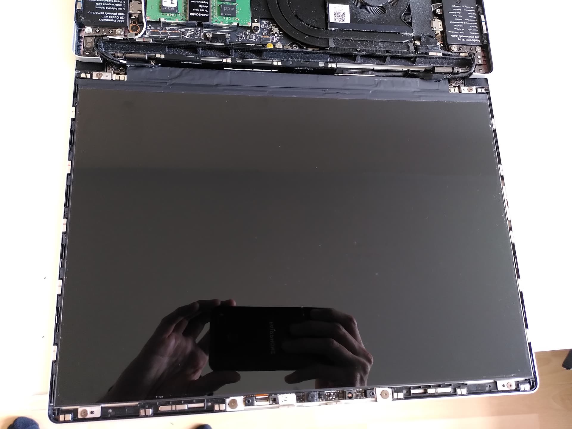

I’m going to have a quick look at the cables following Display Replacement Guide - Framework Guides. Then I’ll probably contact support.
Update: I’ve carefully opened it up. Display connector and wire looked fine. Disconnected and connected it. But sadly the problem persists.

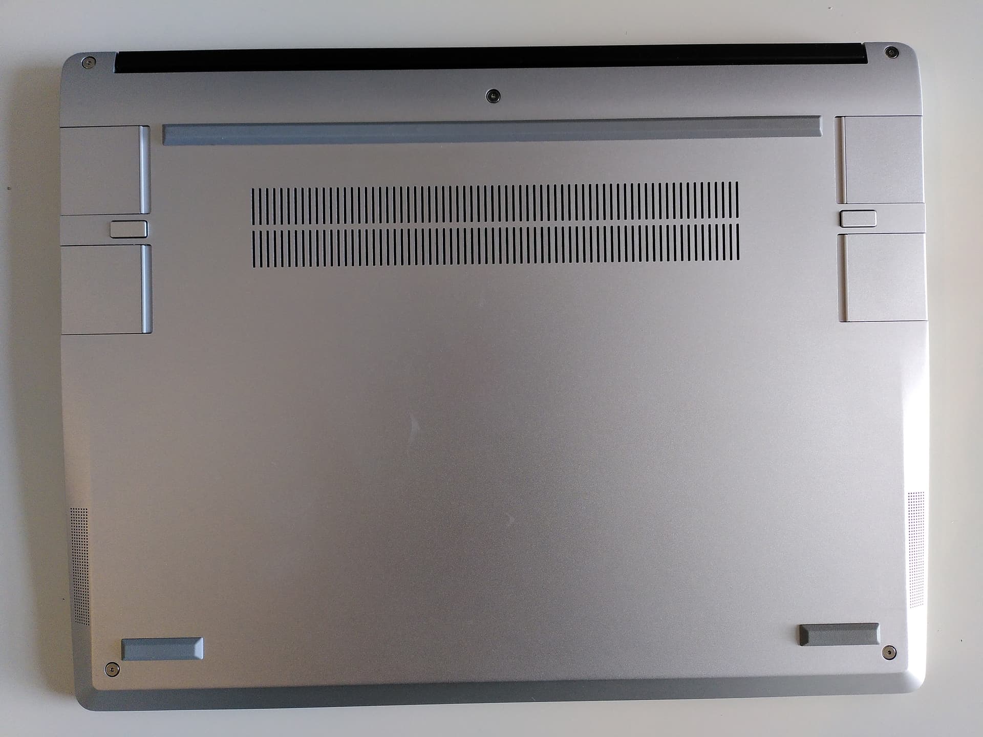

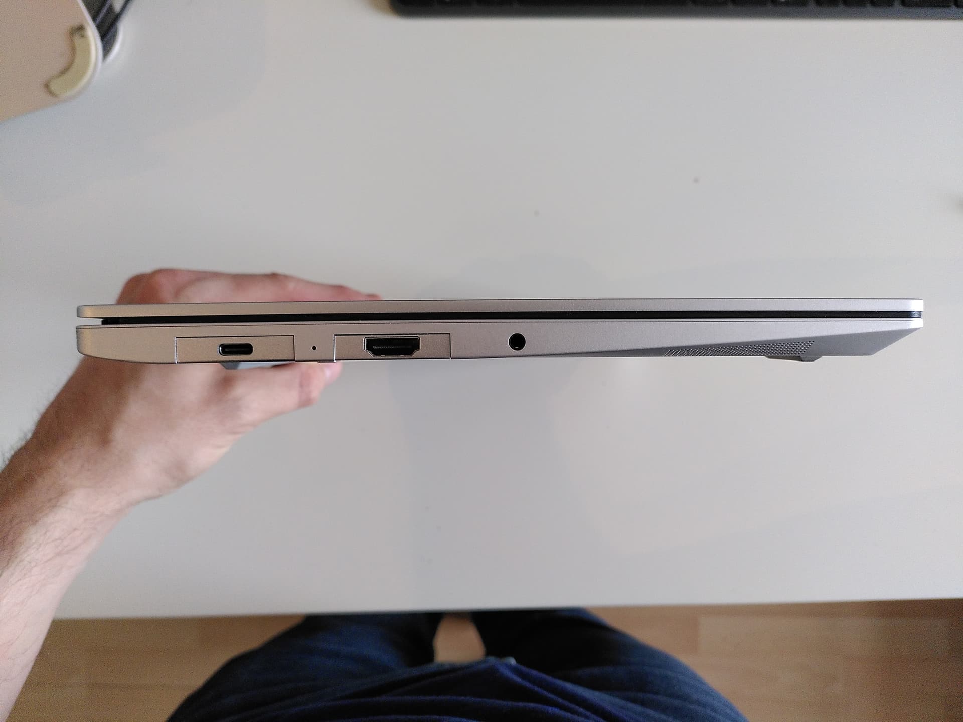

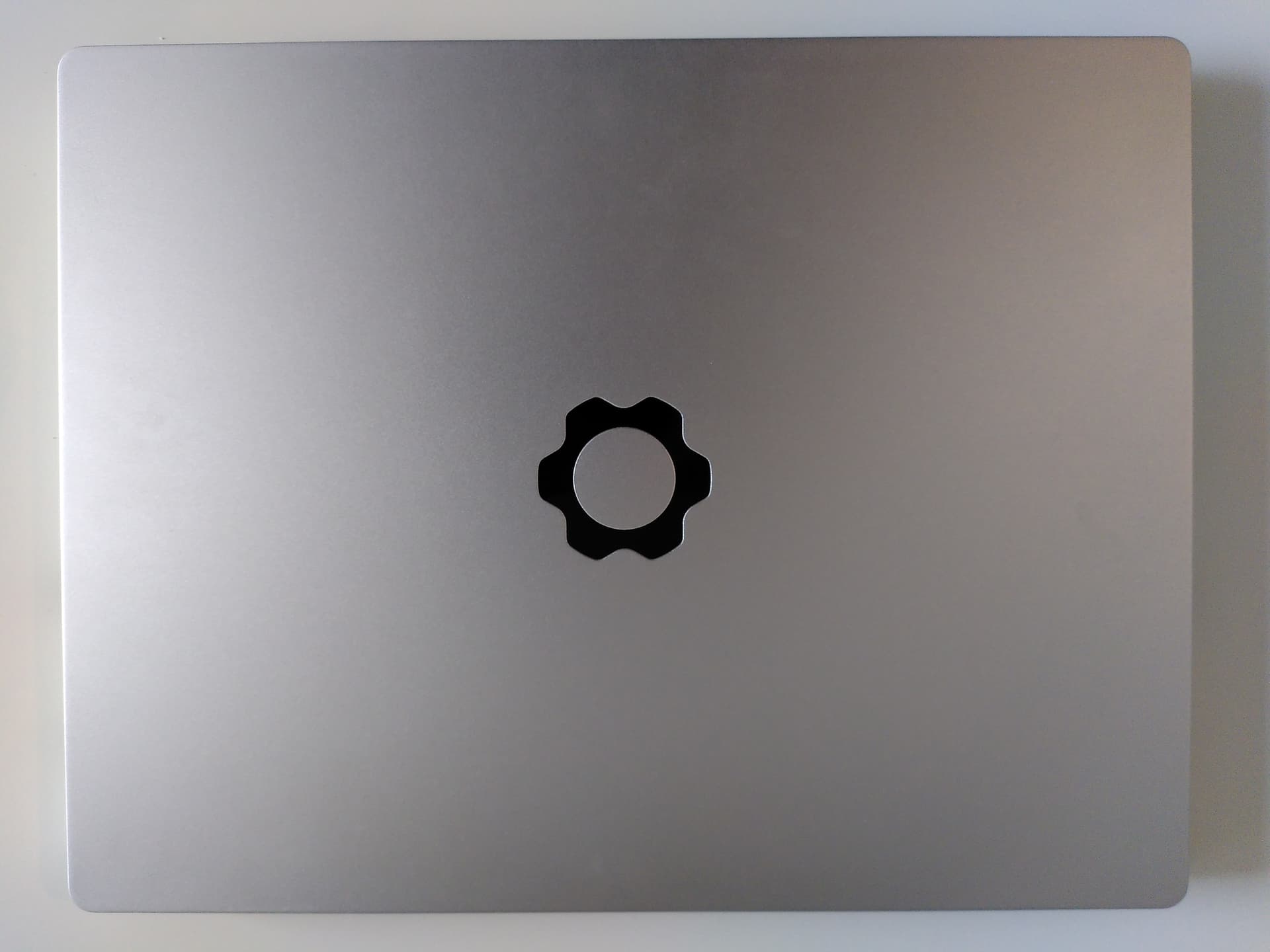

Laptop from all sides:

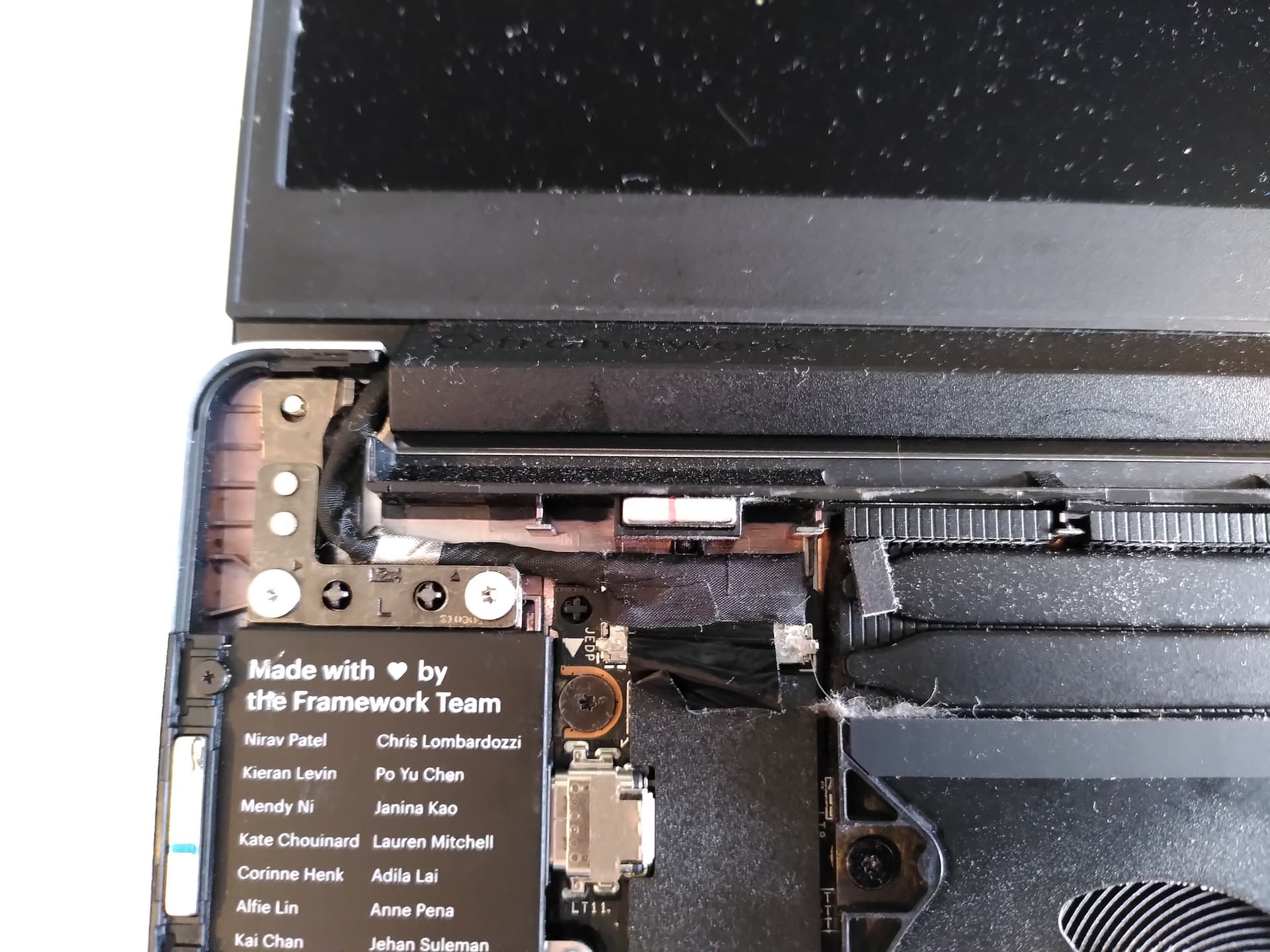

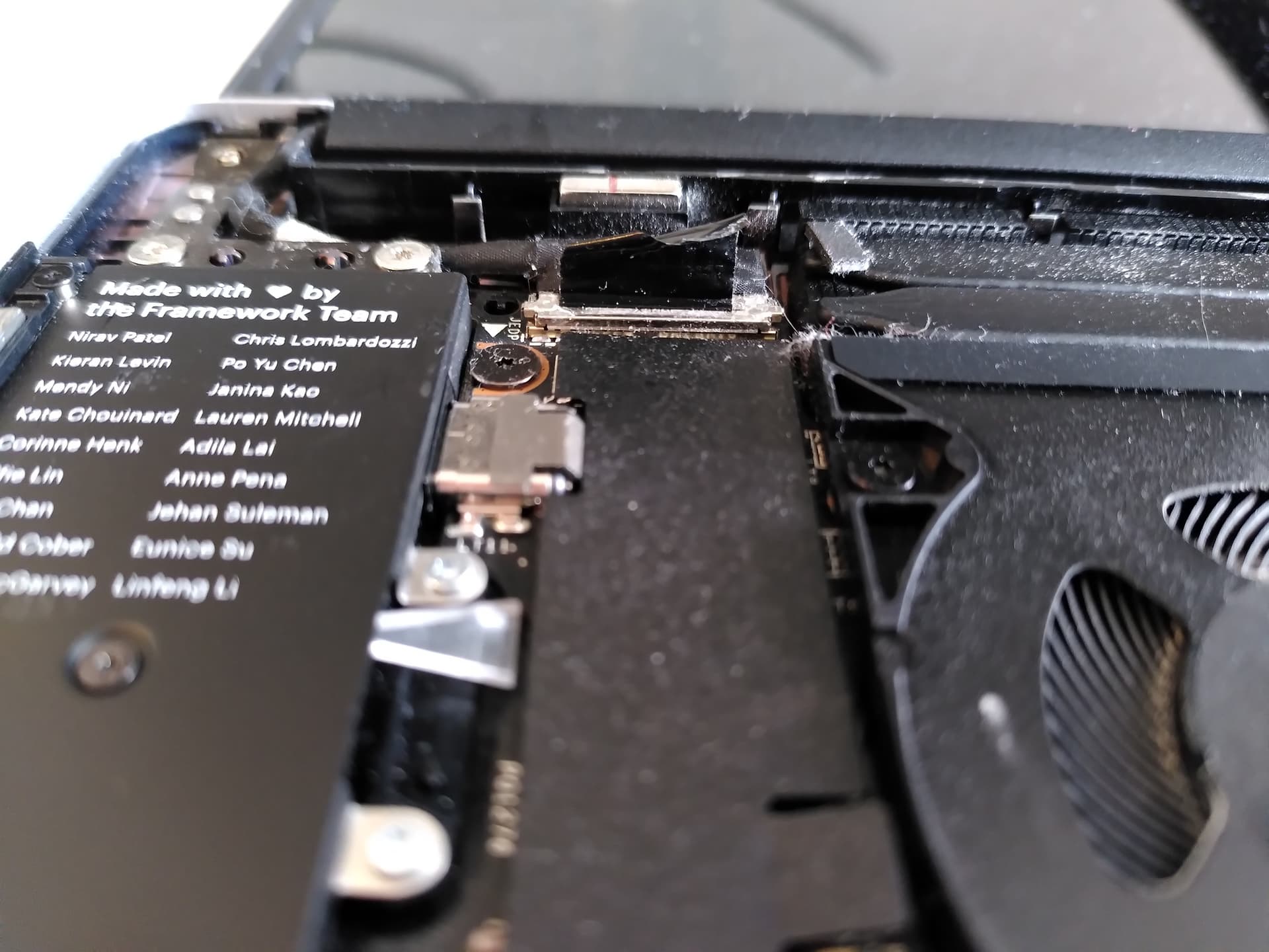

Display connector:
Stripes also visible in BIOS:
After reviewing my photo’s framework decided to send me a new display kit :tada:

I have stickers all over the lid which I did not need to touch (and the replacement display kit, being only the LCD panel not the top cover, I still have them).

  2. Pictures of the entire display while on the BIOS menu (UEFI, but whatever). (pressing F2 during bootup)
  3. Pictures of the entire laptop with different angles (left, right, top, bottom, front, and back). (illustrated)

  6. Picture of the display connector “to make sure that the connector on the mainboard is intact and free of defects”.
