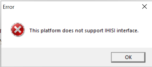

I’m getting this error when trying to run this executable in W11 on the new 12th gen Framework. Any ideas?
EDIT
I just realized this bios is probably only for 11th gen, because that would totally make sense.

@Joseph_Iacobbo This thread is for 11th Gen only. Latest BIOS for 12th gen is 3.04.
