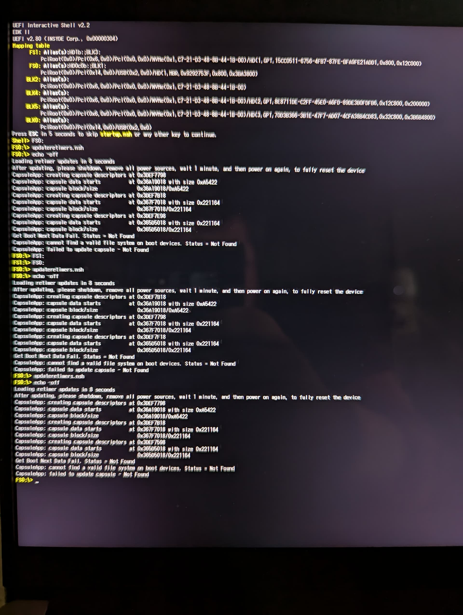

I just updated my Intel 12th Gen Framework 13 from BIOS 3.04 to the latest 3.08 then tried to update the retimers as well which I don’t believe I’ve ever done before. However, after running the updateretimers.nsh it gives the following errors:
Get Boot Next Data Fail. Status = Not Found
CapsuleApp: connot find a valid file system on boot devices. Status = Not Found
CapsuleApp: failed to update capsule = Not Found
I have a fresh install of Fedora 41 on my NVMe drive

I had engaged customer support who was very responsive with this issue.
After updating to 3.06 I was then able to update to 3.08 without issue

  • SUCCESS SKU# and SYS SERIAL NUMBER: Omitting for privacy, IIRC it was a batch 4 or 5 board.
  • SYS CONFIG: i5-1240p
  • RAM: 16GB 3200MHz (2x8GB) Samsung I think.
  • SSD: WD BLACK SN850X 500GB
  • Wi-Fi: Stock Intel AX210
  • External Devices/Other: None.
  • EXPANSION CARD TYPES: 2x USB-A 1x USB-C, 4th bay was empty.
  • BIOS VERSION: 3.05
  • OS VERSION: Fedora Silverblue 41 (Secureblue)
  • STEP TO REPRODUCE: EFI Shell method:
    – Formatted USB2 drive as MBR/FAT32
    – Copied the contents of the .zip to the root of the drive.
    – Rebooted, disabling secure boot, and then let startup.nsh run.
    – First round updated the CSME firmware but nothing else as I forgot to connect AC power and was wondering why it was not proceeding for a while, plugged in and it proceeded as normal. BIOS and related firmware versions (sans SI and TXT as I am unsure how to check those from BIOS or Linux) were as expected.
    – Proceeded to also update the retimers by escaping from startup.nsh and running updateretimers.nsh manually as currently instructed. Confirmed that both were successfully updated to 310 after the first run.
    – Also updated the fingerprint reader firmware through LVFS testing for good measure.
  • OBSERVED RESULT: Successful BIOS and firmware update through the current 3.08d EFI installer method. This is the expected result.
  • EXTERNAL DEVICE MODE or NAME: Some model of PNY 32GB USB2 drive was used.
I am happy that I can report a successful use of the EFI method to update the firmware when using Linux, however I feel I must also mirror what many others have been saying in this thread so far. I feel like Framework has not been handling firmware updates for this board in a proper and timely manner. I admit that this has caused me as well to be hesitant to suggest Framework products to others, as timely BIOS/firmware updates are crucial to maintaining security in our ever-digitizing world today.
I recognize that the issue with the CSME firmware being unavailable for 11th and 12th gen Intel boards through LVFS is an Intel caused problem and is not Framework’s fault. However, I think that Framework has a responsibility to accept this shortcoming and put in a good faith effort to work around it for the support of the community, especially for the enterprise, for as long as Intel supports Alder Lake. In my opinion, the best step forward for firmware support is to validate the factory-installed CSME version or versions against all future BIOS updates to ensure compatibility so that the rest of the components can be automatically updated through LVFS for Linux customers. In the worst case, if this is somehow not possible, the updates should still be provided to LVFS-testing with an update note left letting customers know that they will need to update the CSME firmware through the EFI method as well since Intel does not provide LVFS updates for this platform. This would significantly simplify, and likely stabilize the update process, resolving most of the issues brought up in this thread, as the CSME EFI updater has itself not been an issue. This would go a long way into restoring customer confidence in the company and would show responsibility and transparency in good faith, but I also feel this is the minimum that can be done to restore mine and many other’s faith in the company. Anything less is frankly unacceptable at this point, as it has been nearly a year with no stable Linux/EFI installer. This is not the Linux support I expect from a company advertising as such, and it makes me cautious to trust similar claims for current and future products.
I hope my words help the community feel confident in updating their BIOS, but more importantly that they ring with the team at Framework to get proper support for Linux firmware updates out in the immediate future.

I updated successfully. Only after trying many times and checking the forum often for tips and updates. A less stressful LVFS supported update mechanism would be best for most users, especially non-technical users.
  • FAILURE SKU# and SYS SERIAL NUMBER: FRANDACP04, FRANDACPA42403002X
  • SYS CONFIG: i5-1240P
  • RAM: 32GB (2x16GB Crucial CT16G4SFRA32A.C16FN DDR4-3200)
  • SSD: Patriot P310P240GM28 (240GB)
  • Wi-Fi: None.
  • External Devices/Other: Standalone install in Cooler Master case with known-good 100W USB-C PD adapter; no battery connected. HDMI-over-USB-C display connection and USB-A keyboard in the opposite ports.
  • EXPANSION CARD TYPES: 2x USB-A, 2x USB-C; one of each on left and right side, USB-C on bottom slots
  • OS VERSION: Fedora Workstation 41 (KDE)
    – Formatted USB3 drive as MBR/FAT32 and copied the contents of the BIOS update .zip to the root of the drive.
    – Connected USB-C PD and USB3 drive to right-side ports.
    – Rebooted, then let startup.nsh run.
    – First round updated CSME firmware but skipped the left-side PD firmware updates since I couldn’t swap PD to that side without a battery installed. BIOS update did not continue.
    – Shutdown, swapped PD and USB drive to left-side ports.
    – Second round updated left-side PD firmware, then threw Error 331: Full FW Update using same version is not allowed. Include -allowsv in command line to allow it. and proceeded with BIOS upgrade attempt.
  • OBSERVED RESULT:
    The BIOS updater halts and immediately powers the system off after reporting success writing firmwarehdr.cap.
    Loading BIOS updates in 4 seconds
    CapsuleApp: creating capsule descriptors at 0x3F087798
    CapsuleApp: capsule data starts          at 0x37C00018 with size 0xA5422
    CapsuleApp: capsule block/size              0x37C00018/0xA5422
    CapsuleApp: creating capsule descriptors at 0x3F087B18
    CapsuleApp: capsule data starts          at 0x3598B018 with size 0x2274DC4
    CapsuleApp: capsule block/size              0x3598B018/0x2274DC4
    Found EFI system partition on Boot0001: Fedora
    FS0:;HD0b:;BLK1: PciRoot(0x0)/Pci(0x6,3x0)/Pci(0x0,0x0)NVMe(0x1,00-00-00-00-00-34-68-48)/HD(1,GPT,D9BDF3C6-EA59-4F1D-8914-6865A172C442,0x800,0x12C000)
    Succeed to write winux.bin
    Succeed to write firmwarehdr.cap
    The system then immediately shuts down. Rebooting into the OS works, and I can confirm there that the BIOS update did not take.
    I re-attempted by rotating PD and USB drive from left to right side, then rotating USB-C and USB-A ports from bottom to top, then again from right to left side. All result in the same behavior.
    I then wiped the USB drive, unzipped the 3.06 BIOS update onto it, and rebooted into the updater. The upgrade worked without error or issue.
    I then wiped the USB drive, unzipped the 3.08 BIOS update onto it, and reattempted the above steps to reproduce, including iterating on port usage and expansion card placement. All halt at the same point and fail to upgrade the BIOS.
    I am now on BIOS 3.06 and have stopped attempting to upgrade to 3.08.
  • EXTERNAL DEVICE MODE or NAME: SanDisk Corp. Ultra Fit 16GB USB3 thumb drive connected to USB-A expansion card
