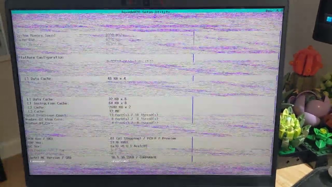

  • FAILURE SKU# and SYS SERIAL NUMBER: (can’t locate), FRANDACPA423240066
  • SYS CONFIG: 12th Gen Intel(R) Coreā„¢ i5-1240P
  • RAM: G.Skill Ripjaws 8GB x2
  • SSD: WD SN770 500GB
  • Wi-Fi: Intel AX210
  • External Devices/Other: none
  • EXPANSION CARD TYPES: 2 x USB-C, 1 X HDMI, 1 x USB-A
  • BIOS VERSION: 3.06
  • DRIVER PACKAGE VERSION:
  • OS VERSION: Windows 11
  • FAIL RATIO: One attempt
  • STEP TO REPRODUCE:
    Using Windows package (3.08b)
  1. Double click to run the installer.
  2. A command line window popped out.
  3. Rebooted Windows
  4. A screen showing a system upgrade is being installed and a green progress bar appeared. Just as it reached 100% the bar dropped back to something like 97% hung for a bit and then the System rebooted.
  5. System lit up again with the same upgrade screen with green progress bar but with screen flickering. Similar to what is seen in the attached video. It rebooted again before reaching 100%
  6. Once more with the upgrade screen and the flickering, went to get my phone to film it when I came back it had rebooted this time with the normal framework boot screen under all the flickering as seen in the video. flickering resolved once windows boots.
  7. Confirmed 3.08 is installed in msinfo32.
A> After opening the case to get serial info for this post. The screen stopped working all together, in or out of windows. I am able to connect to an external display (DP over USB-C) or remote into it and can see the screen is detected and appears functional to the system. The screen is dark and off.
  • OBSERVED RESULT: Install succeeded?? but caused screen issue, or screen failed at a really bad time?
  • EXPECTED RESULT: expected to work and not bork my screen
  • ISSUE RECOVERY METHOD: would like to roll back to previous bios but unable to find a download for it! Will reach out to support.
  • EXTERNAL DEVICE MODE or NAME: n/a
If this only happened after opening the laptop, I’d open it up again and have another look at the display cable (correct routing around the hinges?, connectors plugged in completely?, any kinks?, etc).
well this keeps getting stranger.
  1. I tried reseating the display cable and then it stopped detecting the internal screen all together. (now I was worried I did break it).
  2. Tried reseating it again and very closely checked the routing, all looked good.
  3. Booted again and screen was flipping from detected and not detected on the display settings and I saw the backlight come on for a moment a few times. Disconnected the second screen and hopped into the remote desktop app on my phone. Hoping it could figure it out. After a bit the backlight came on and showed my desktop with loads of green snow (pixels) flowing upwards, that slowly dissipated over time. yay?!
  4. Rebooted to make sure its still working. I have no display at all until the windows screen but then everything is looking fine.
I’d really like a download link to the 3.06 bios so I can roll back and eliminate it as a variable for this screen issue!!!
Same boat. Use the same 3.08b file. Update was successful.
Computer was Batch 1 - i7-1260p.
For anyone in the future. Framework support bailed me out. The support team is fantastic. I am now verifying if the bios components updated correctly, but after a few days of troubleshooting, I have my framework back up and running.
If you are up for it you might check the connection on the display side - that involves removing the display, so it’s a bit more involved. I would also open a Support ticket if you have not already done so. Obviously something isn’t right, and you need to be able to have a working system. Best of luck.
