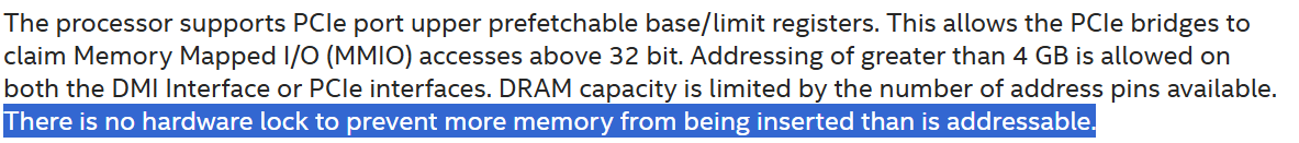

According to intel’s documentation, the max ram for the i5 1334u is 96gb but that might be dual channel only. What this means is that it could probably work, but it may not be able to address all 64gb, but if you upgraded to a newer platform later that would be able to address all 64gb. The problem is that when the documentation was created, there was no 64gb dimms so theres nothing on single stick 64gb ddr5 sodimm.
Here’s the link to the documentation whitepaper https://cdrdv2.intel.com/V1/DL/GETCONTENT/743844
Those numbers are from before 64gb sticks were available. The 8th gen mobile cpus also said 32gb (2x16) max but when the 32gb sticks came out those worked just fine.
These days we got like TBs worth of address space so I highly doubt that’ll be the issue.
