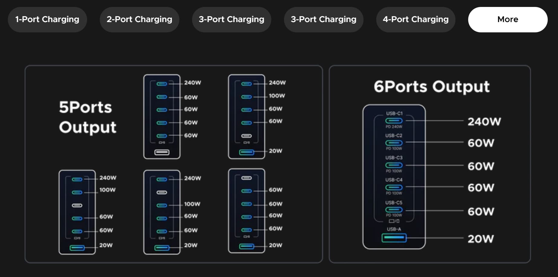

Yes, the top one is 240W. It can do the top at 240W and the rest at 60W(without the type A) concurrently. It can also do 240W, 100W and 60W at the same time, so easily a family charger
If it shows up in the US and isn’t…too terribly expensive, I might give it a go. For science, lol.
Theay mention every possible configuration on the website.
The nice thing: The top port is always 240W. So it should not renegotiate when anything else gets plugged in.
