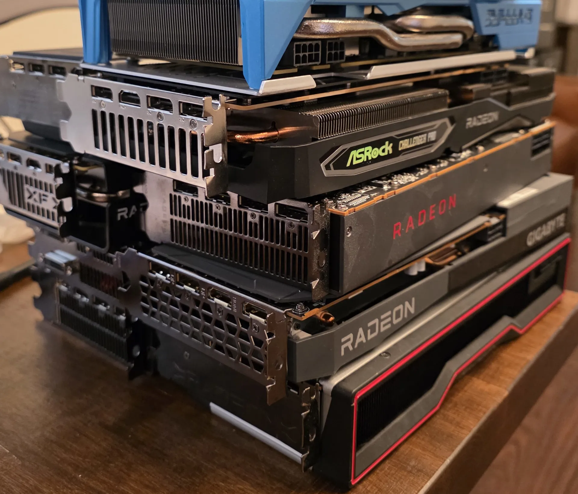

he also mentions the following post on Phoronix:
I quote:
"[…] But when it came to testing on Linux 6.19 with the newer AMD Radeon graphics cards, that’s where things went downhill quickly. With Linux 6.19 and also confirming back on Linux 6.18, namely with the newer graphics cards they were all hitting hard hangs – some cards more quickly than others, but on none of the RDNA3 and RDNA4 GPUs could I end up with a complete run of the benchmarks.
With these newer graphics cards on Linux 6.18/6.19 there would end up being hard hangs when running different benchmarks. I had heard of some Linux gamers and users in the forums complaining of issues but not until this latest round of testing did I discover how bad and widespread this issue was with ultimately abandoning my holiday testing of the RDNA3/RDNA4 cards due to this outstanding regression.
They were hard hangs in not being able to remotely access the system and no kernel logs archived to disk. I confirmed as well with the Valve Linux graphics driver folks that they too have encountered this behavior on Linux 6.18+ with this rather show-stopping issue. So far no issue resolution from AMD nor does it look like anyone has bisected this issue yet."
As most of you (like me) are going to run, or in fact are running Linux using various RDNA 3/4 AMD GPUs it might be good to be aware of this.
