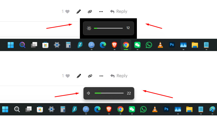

I also noticed some weird glitches here and there, for example, when adjusting brightness, there is that contour around/behind the popup, but it’s not showing up under the volume one (see screenshot below). Weird. Similar things also happen sometimes in Explorer or different programs, or sometimes when dragging windows it seem to be lagging, like in a game when vsync is not turned on. And other similar weird small glitches here and there…
I really hope these are GPU driver issues, and the GPU is not having any hardware damage/fault.

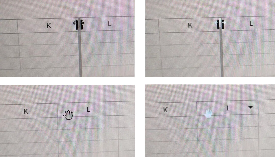

  • the mouse cursor sometimes blinks and turns cyan around specific elements, like when dragging columns in sheets or moving things around with the little hand cursor. I’ll add a picture at the end of the post for reference. This started right after the fresh install of Win 11 Pro, and it was the first sign suggesting a GPU driver issue;

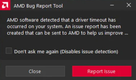

Upon looking in the Event Viewer, I see this log related to AMD once again:
I really hope there will be some fixes and better updates coming. This device has been out for almost a year already…
Btw, I sent my dumpfiles over to Microsoft, and they confirmed it’s the AMD drivers:
Your minidump files indicate the chipset drivers and the graphics drivers as the cause of the system crashes, that is also the most likely cause of the resume from hibernate problems.
