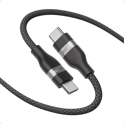

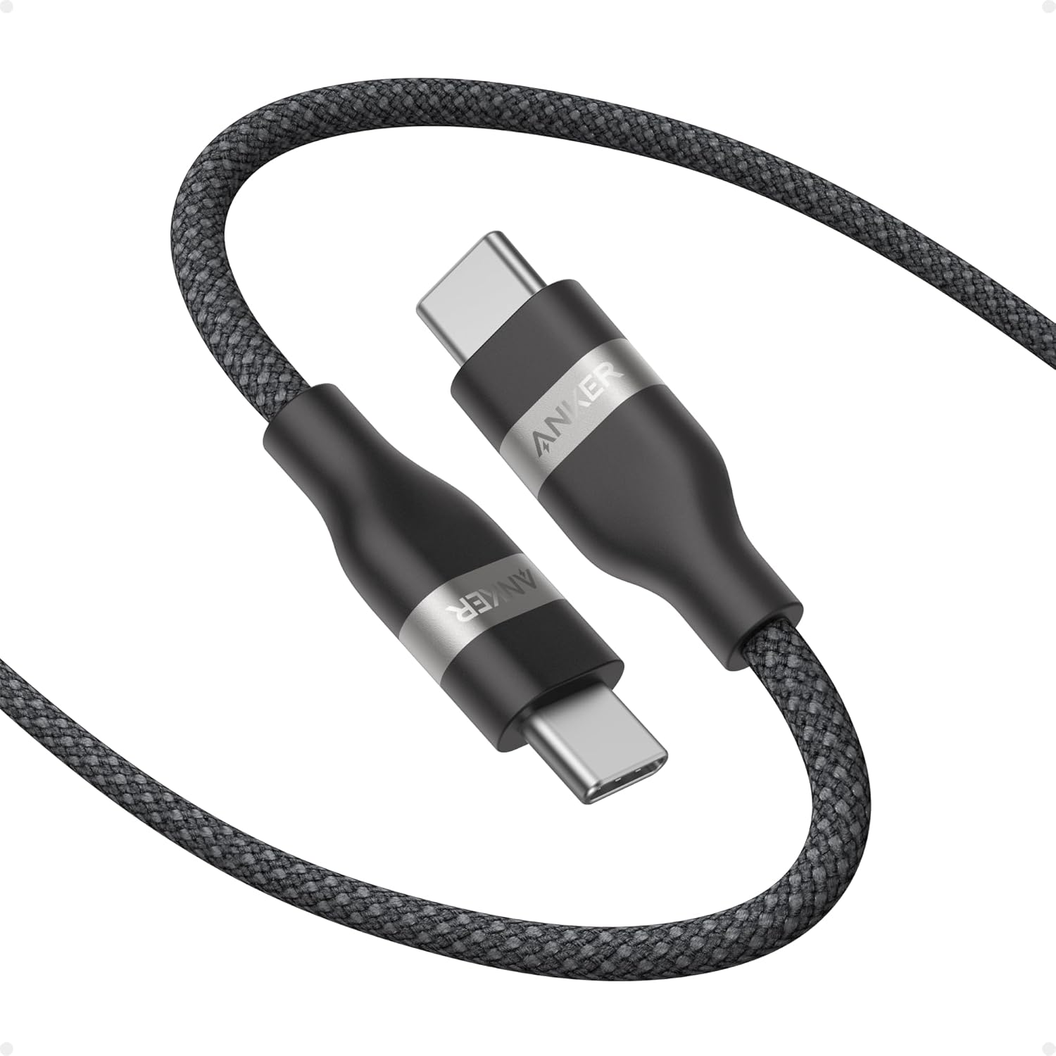

Often, cable damage comes not from use, but how it’s stored/carried. The tighter you bend it over and over, the faster it gives out. How tight is “too tight” varies, which brings me to my love of floppy power cables.
This is a 240W very floppy cable from Anker that I love. I bought it for my FW12, but have used it on my FW16 and a range of other devices.
It’s held up well for me… and it gets more use than the cable that came with my official FW16 charger.
