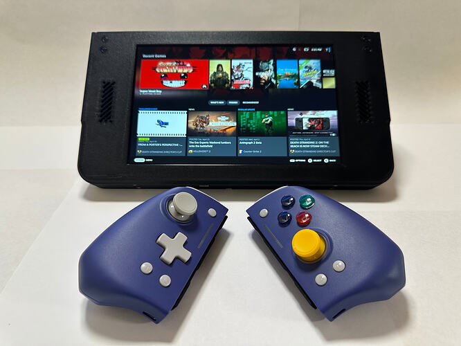

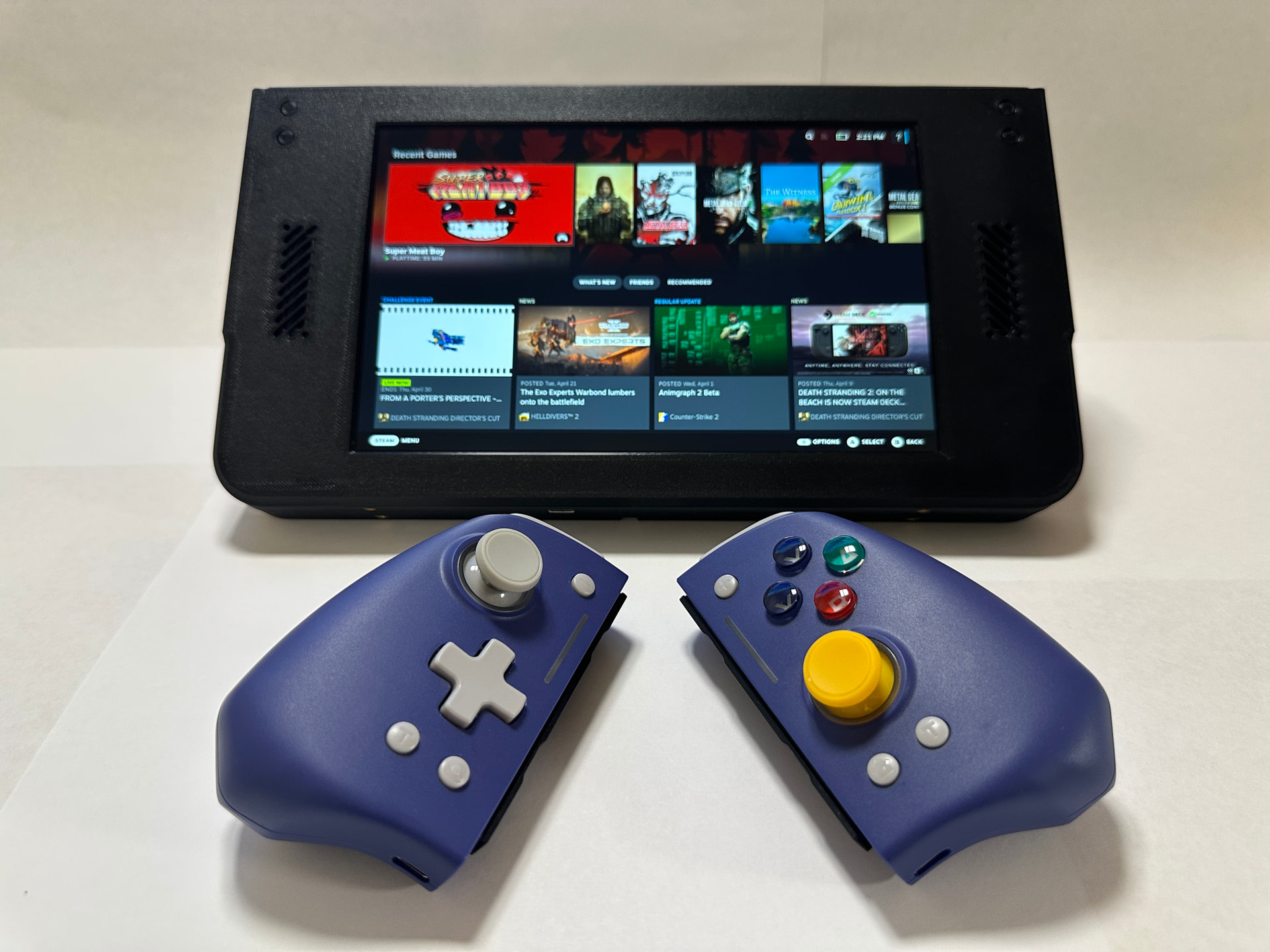

Wanted to show off a project that I’ve been working on ever since I heard about Framework. I’ve built a handheld gaming pc that uses the Framework 13 motherboard, battery and speakers. Thrown into a 3d printed case with some other electronics. All the information is on my GitHub. https://github.com/blt3dp/D-Pad
Features:
Able to use any Framework 13 Motherboard and Battery
8.9" IPS Touchscreen
Front facing speakers
Joycon docking/charging
Framework Expansion Card compatibility
Docking station connector
Power and volume buttons
Kickstand
Additional expansion provisions

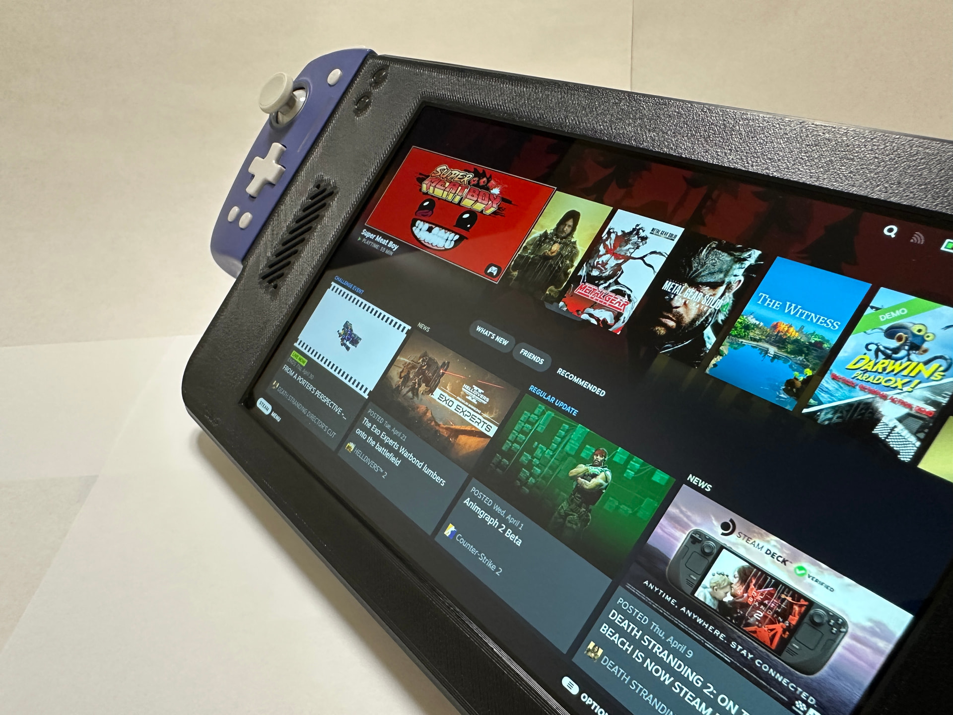

I’ll add pics of the top and bottom. But, there are also threaded inserts on both that can be used to attach add-ons. For the top, I had a thought of a bolt-on attachment to add a clamshell type 2nd screen.
For the bottom, there’s a docking port. But that could be repurposed for some type of attachment as well.
