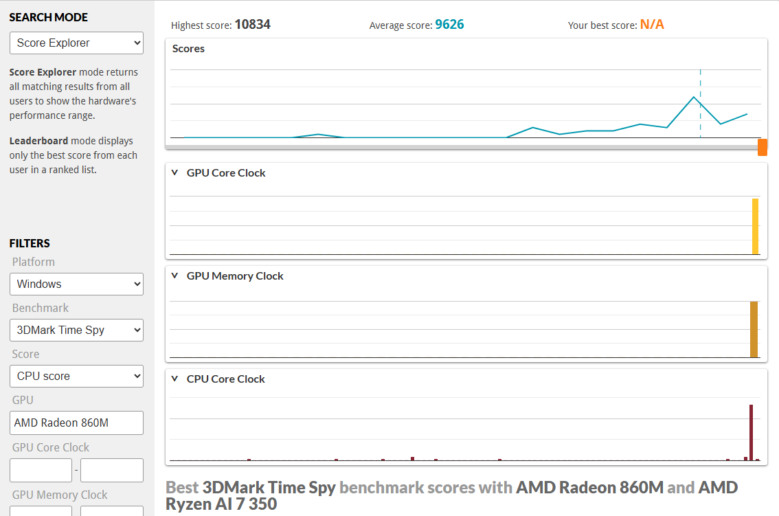

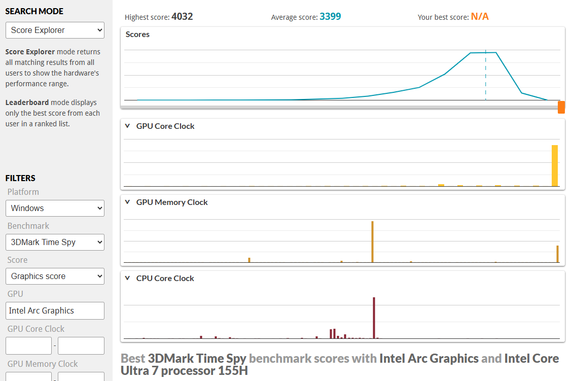

3DMark TimeSpy scores:
Ryzen 7 CPU - Avg 9626
Ryzen 7 GPU - Avg 2741
Core Ultra 7 CPU - Avg 8131
Core Ultra 7 GPU - Avg 3399
Tracks with what I stated, Ryzen 7 CPU pulls ahead slightly and the Core Ultra 7 GPU pulls ahead slightly. I honestly can’t find a ton of real world head to head comparisons other than the initial review videos at both laptops releases.
