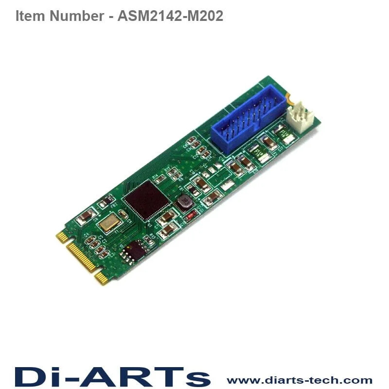

You could get a M.2 USB 3 or USB C controller to interface devices with your mainboard and use the built in display. I’m sure a case could be made with a touch screen display and USB ports on the sides. Or you could use a M.2 SATA controller M.2 card and mount the mainboard in a PC case (Framework Micro-ATX Mainboard & Battery Adapter by greytrimble | Download free STL model | Printables.com) but I’m not sure how you’d get display with your USBC ports not working and how you’d power your SATA hard drive.
