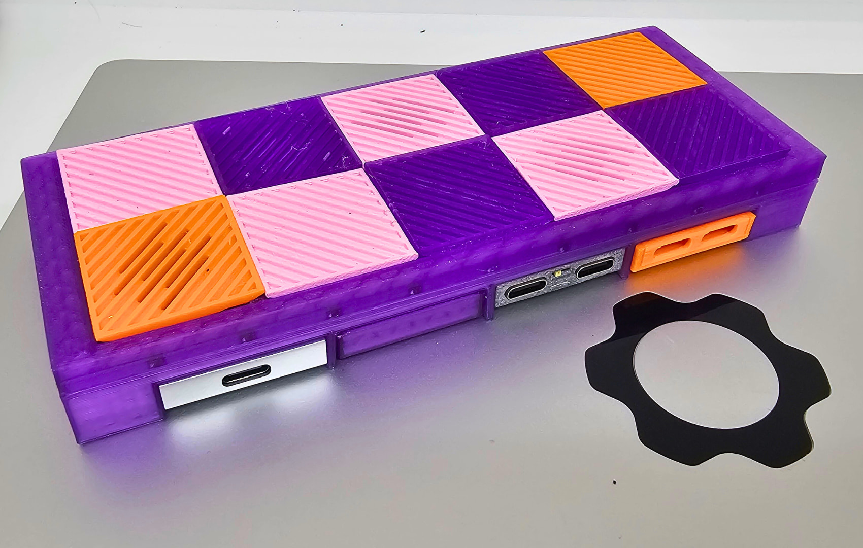

About supporting 8 cards, we designed the enclosure to be “lego attachable“ to each other so you can stack them or add lego artifacts on top (small toys, decoration, small electronics kits, etc), see this prototype:

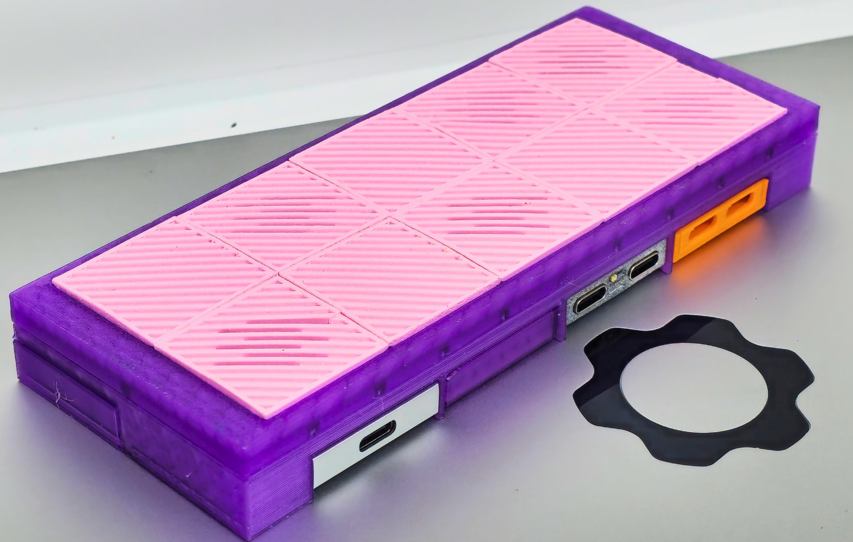

First prototype photos:

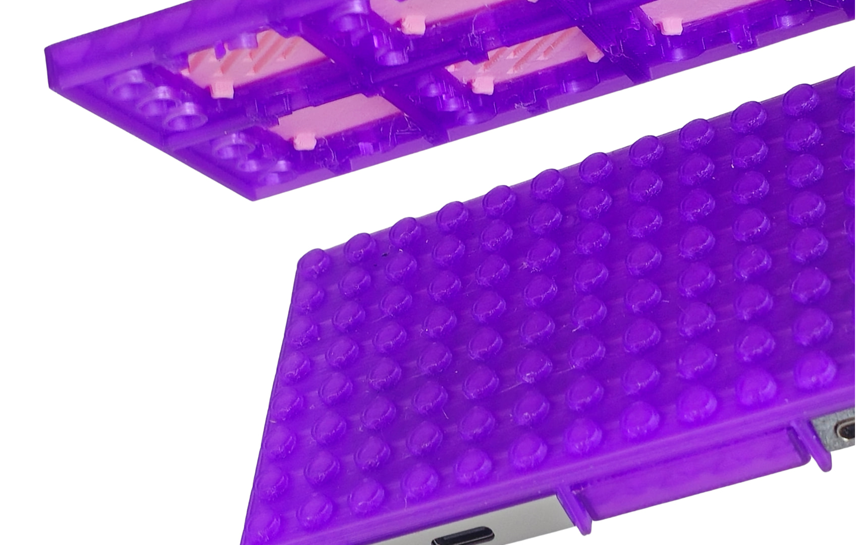

Why the Lego studs?
