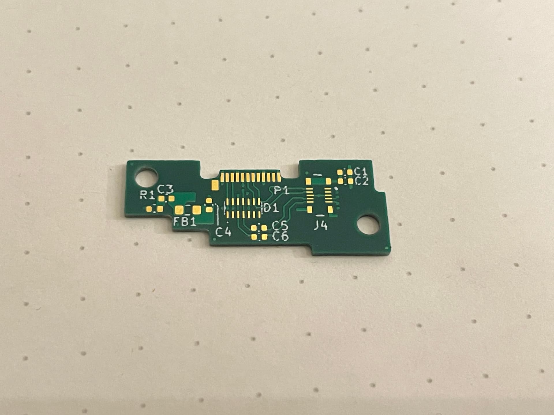

The new fixed daughter-boards arrived yesterday and I did assemble one tonight.

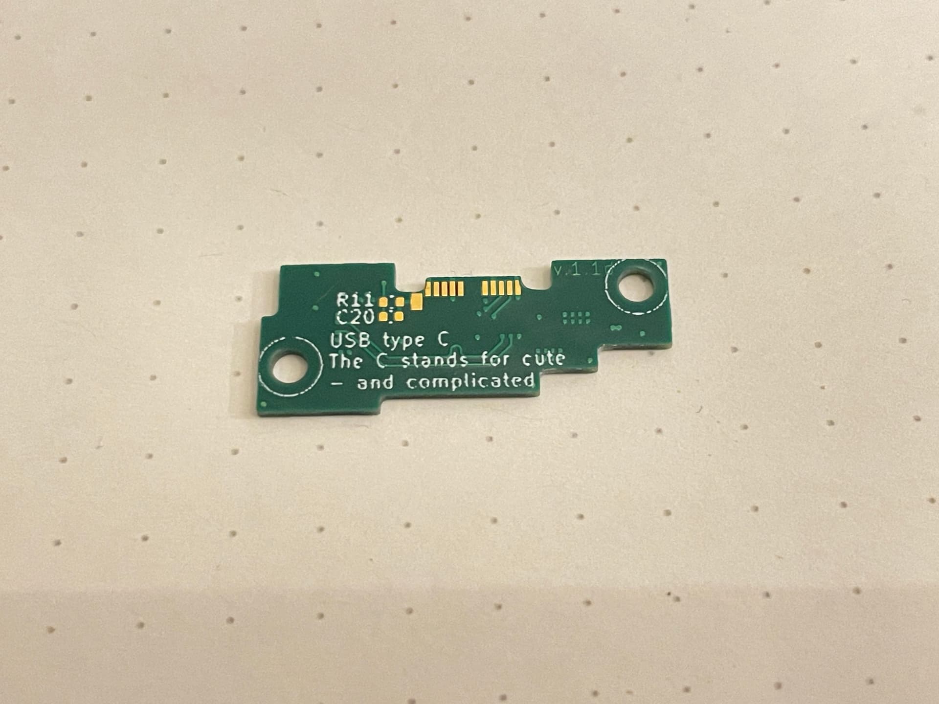

Optically not much of a difference:
I did adjust the silkscreen-text to my experiences so far :joy::

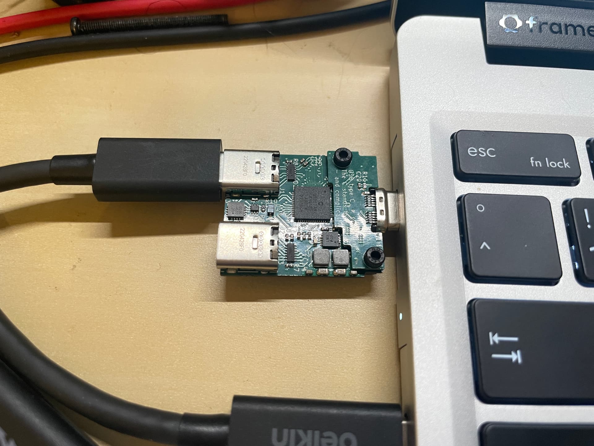

The whole thing connected:

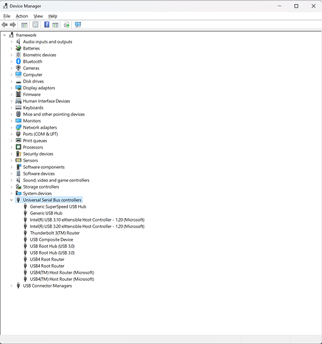

And we actually do now have a USB 3 device :blush:.

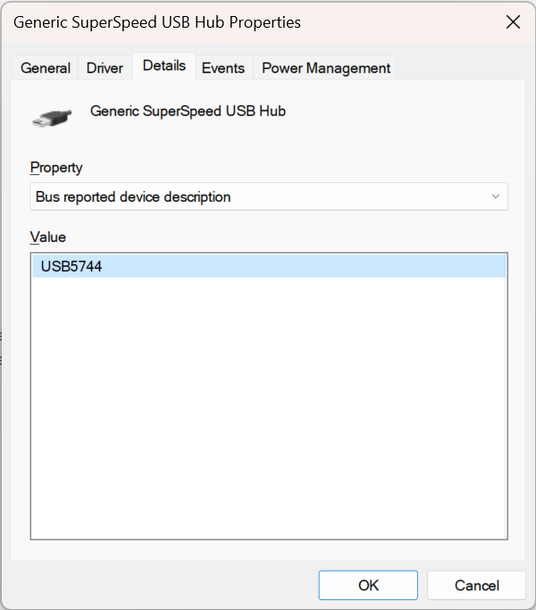

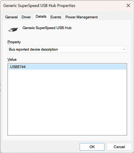

The two generic ones are the from the hub controller:
The USB 3 section of the controller:
The USB 2 part:
