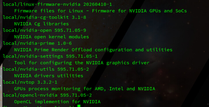

After a pacman -Syu update the displays on an (expansion #4) attached thunderbolt 4 dock (which I’ve read isn’t strictly compatible with the AMD processor, but previously worked regardless) have stopped working. Either one or two monitors being plugged into the dock, only a single “Doble” display shows up in the settings, and enabling or disabling it does nothing.
So I took one monitor and attempted to use it with the Displayport usb-C puck only for it to not be recognized in the GUI settings app. Dmesg appears to show the DP puck disconnecting when the display is plugged into it(?).
The laptop BIOS menu has Hybrid Graphics selected, which I believe previously would have both the iGPU and nvidia one show up.
The current nvidia driver is 595.71.05
