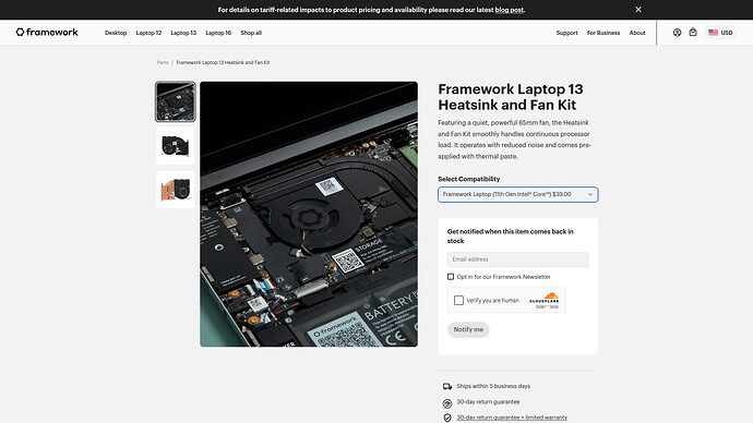

In another thread in the forum Kevin_Kinney seems to have had the same issue, which was resolved by changing the fan. Unfortunately, I cannot see the fan on the parts page for the 11th gen intel chip - actually the only one there is, is for the Ryzen AI 300.
Could they be modified to fit to other chips?
As much as I am convinced of the framework approach, the fan issue seems to be common and now not finding a heat sink is obviously unacceptable.

I can find the Fan-Kit on the parts page. Is it different in your region?
Framework | Heatsink and Fan Kit
Not where I am.
Got a new fan kit, which solved the problem.
