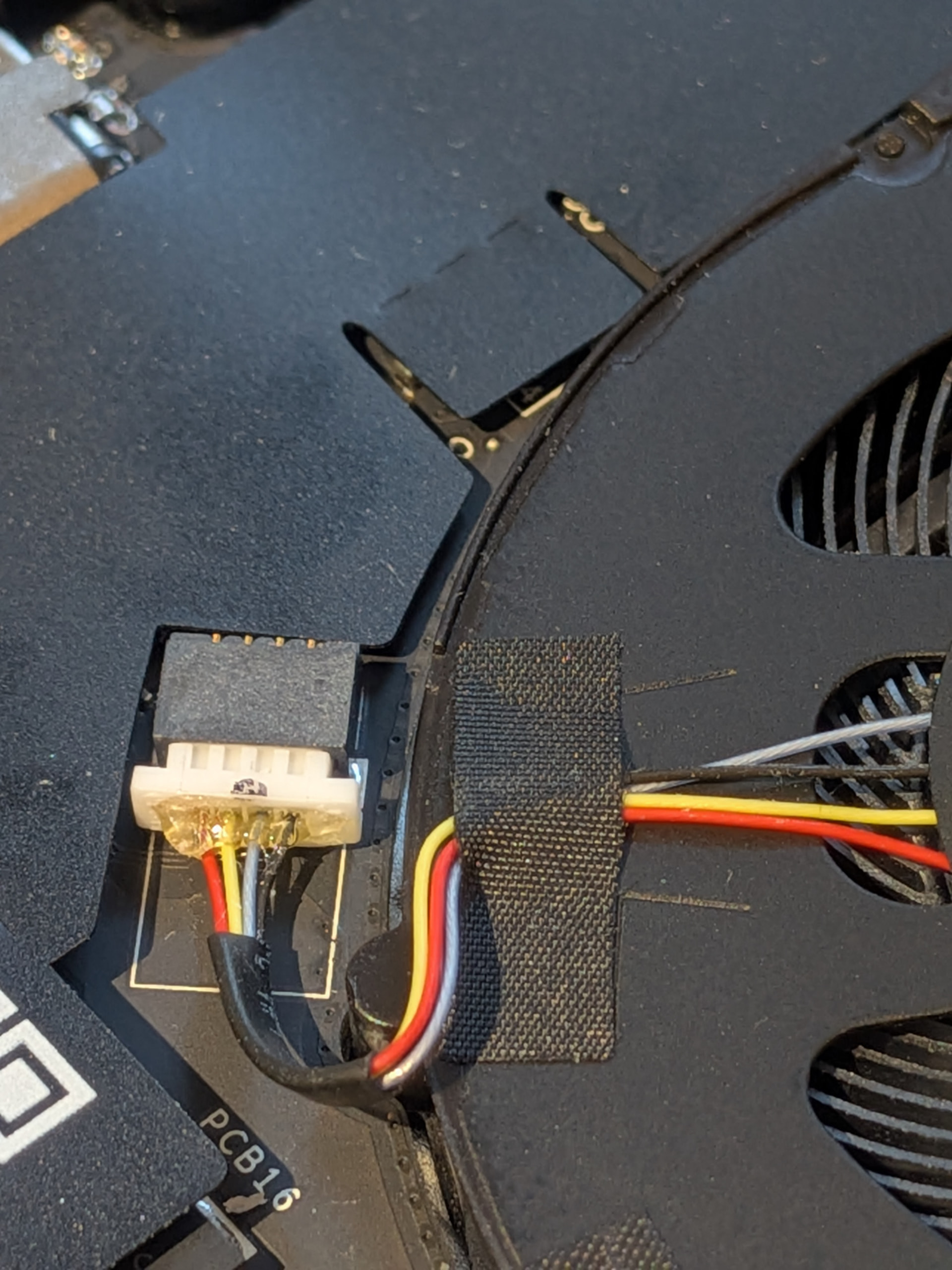

I first swapped the stock heatsink for a Ryzen 300 heatsink and everything worked fine. Then I reinstalled the original heatsink, this time using PTM7950 to compare performance. Since then, the fan no longer ramps up (it doesn’t seem to spin at all), and the laptop eventually shuts down when temperatures get too high. I’ve tried to put again the ryzen 300 heatsink, same issue, the fan won’t spin.
What’s strange is that the behavior is the same with both heatsinks/fans, so it seems unlikely that I somehow broke both fan cables.

Update: video fan spinning at boot and video of fan not spinning when temperature are reaching more than 60° password –> framework
Before, the fan was spinning when temperature was reaching ~47°
Any debug idea anyone ?
