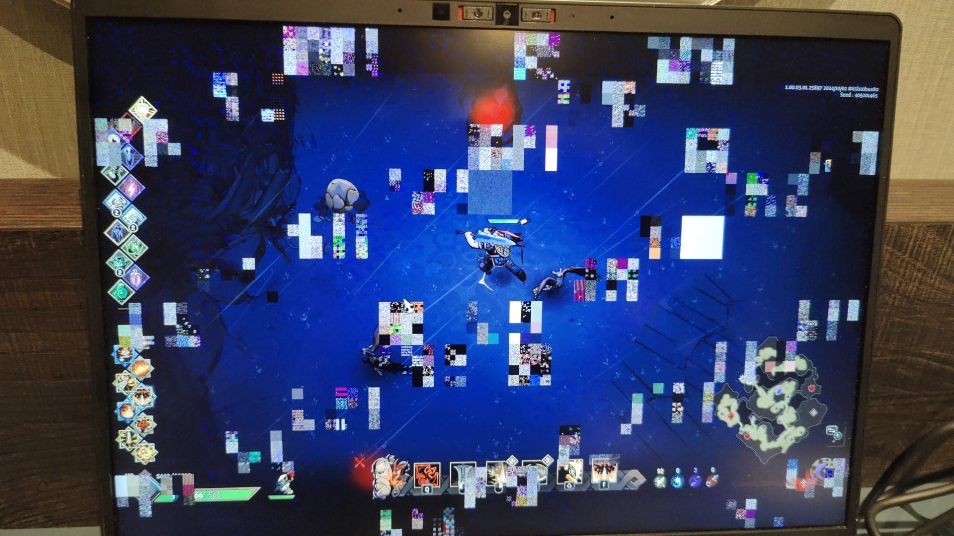

While playing games (and ONLY when playing games) either screen freezes with graphical glitches:
or just hard reboots the pc.

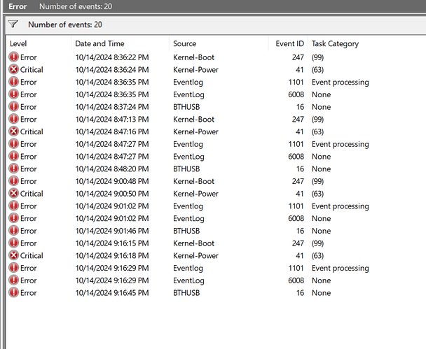

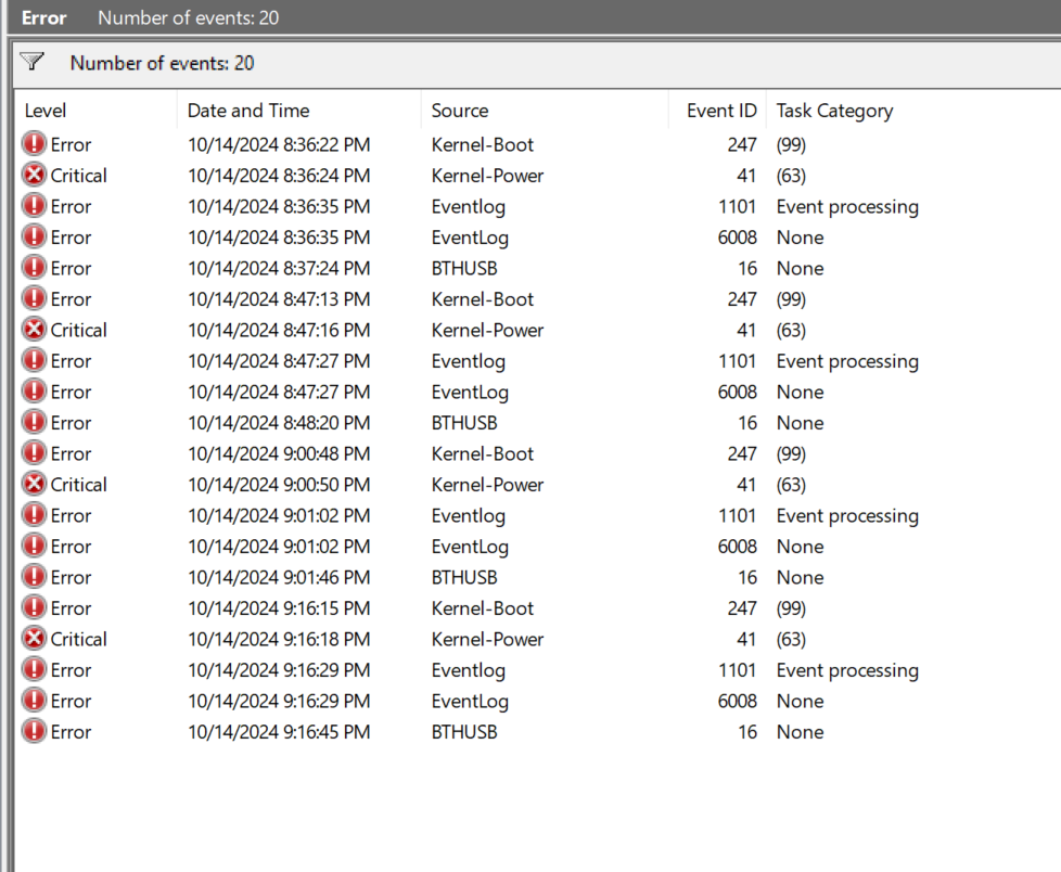

Happened 4 times in the last hour. I have eventviewer logs if anyone is interested, I can’t get much out of it (skill issue).
