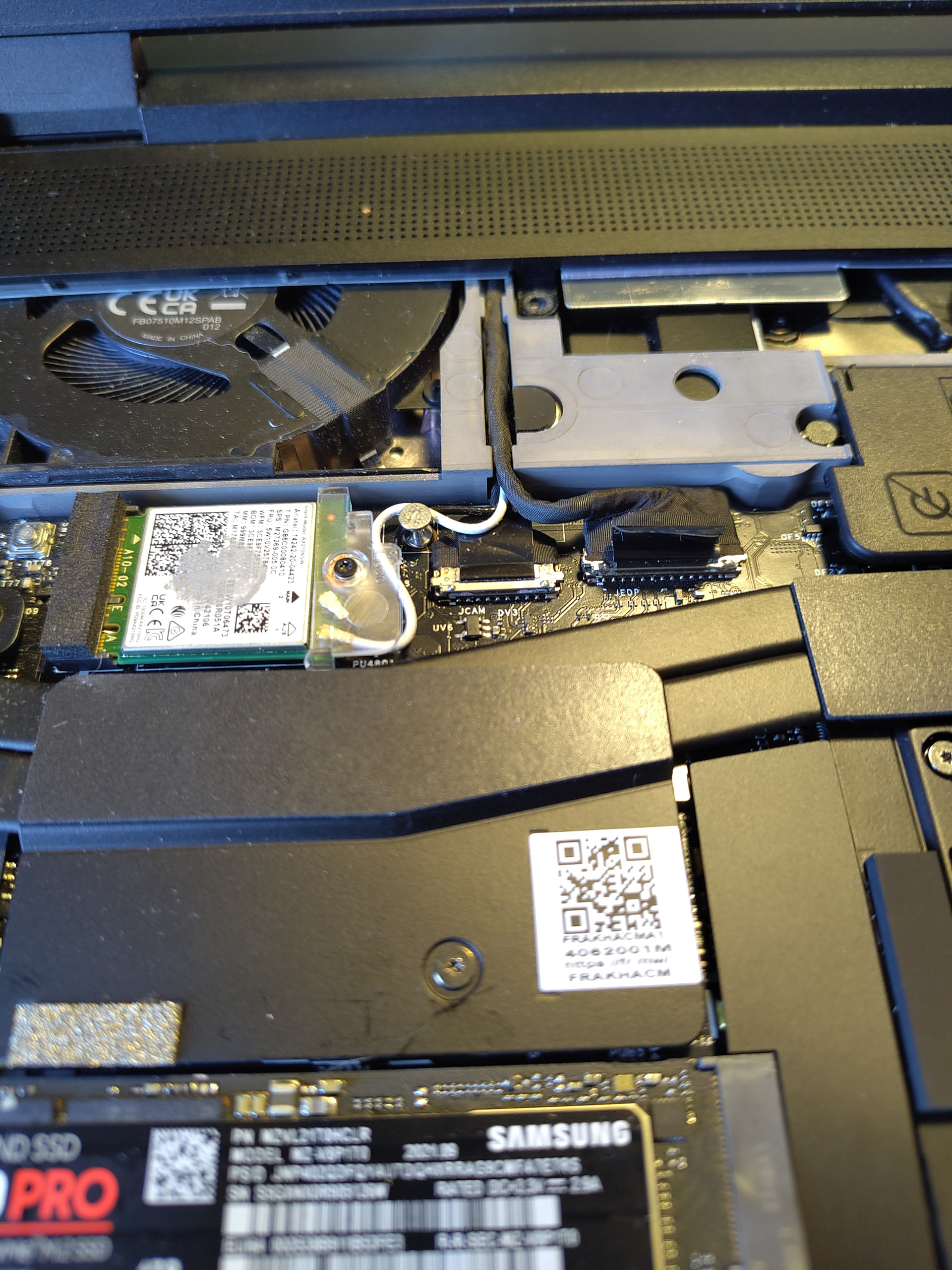

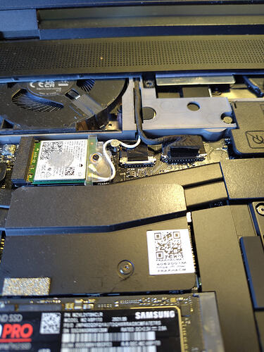

I have checked the display cables and everything looks okay by my eyes, I’ll still try re-seating it though.
Update: The flickering issue seems to have gone after reseating the display cables, although when it did happen it did seem to get less noticeable over time so I don’t know if it fixed itself or my actions fixed it so I’m still very uncertain about what happened (or caused it to begin with), I have submitted a support request.
