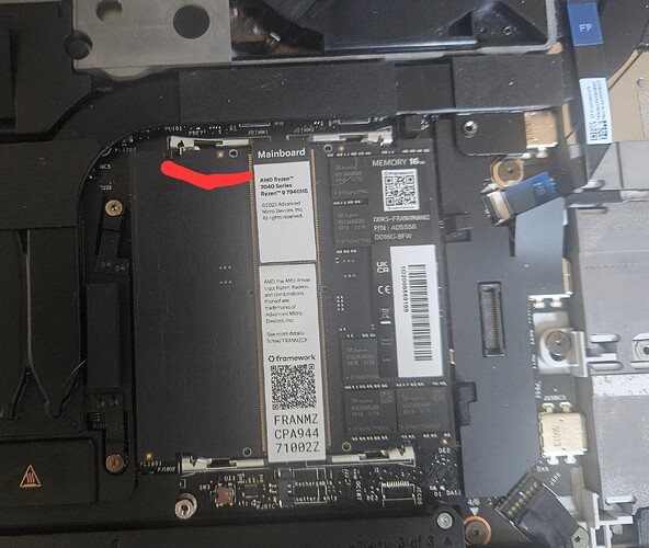

Would that bend be any concern. The fans on the laptop were beginning to make loud noises, so I go in the check if something was causing the noise. They appear to be clean.

I could be wrong, but it kinda looks like your ram is not pressed all the way in the slot. I’d have to open mine to compare, but I think the key should fill the notch on the ram stick and there should be less (or none) of the metal contacts visible.
I would agree. The ram is not installed correctly. Both ram chips are not correct
The bend is typically there when the ram is not seated properly. I believe those are spring tabs and they are there to hold tension of the memory after the gold contacts are seated inside the connector. I agree with some of the others that the memory may not be seated correctly. I am not near my Framework to check but I believe all or nearly all of the edge connector is covered once it is correctly inserted into the slot.
They go in at an angle (30 degrees?) and then are pushed down flat and the spring tabs snap over the notch to hold the ram in place for each slot.
You might have your local shop “re seat” the memory and see if that helps the issue. Regardless, get a conversation going with Support and maybe you can enlist the help of your local shop so Framework can determine what the cause is.
I am hoping it is something simple for you like the memory not seated correctly. This is not common but it does happen.
Spot on. Ram can do amazing things when not correctly installed. Turning on and off my device was my previous issue.
I am kinda impressed it even posts like this.
