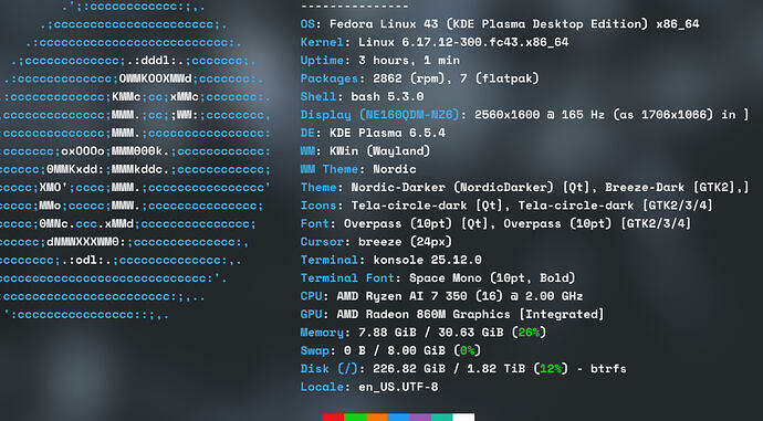

I’m using Fedora KDE 43 6.17.12-300.fc43.x86_64 with the BIOS 03.04. I’m using the AMD AI 350 CPU with no GPU. I have three USB c expansion cards, an HDMI, an audio, and a USB c.
I got this laptop a few weeks ago, and everything was running fine until the top two ports stopped working, they wouldn’t charge at all. I disconnected then reconnected the battery and that worked for a day, and now it’s back to it, but only the top right port for some reason. Running /sys/class/typec/portX shows port stuck in source role with no partner detected, and Kernel logs show PD negotiation failures (UCSI_GET_PDOS failed). I’ve also done a Hard EC reset, but that hasn’t proved successful either. I’ve looked at other forum posts and I can’t find someone whos has this issue that wasn’t fixed by that, so I’m not sure what else to do at this point. I submitted a support ticket because I think it might be a hardware issue, but I’m not entirely sure.
