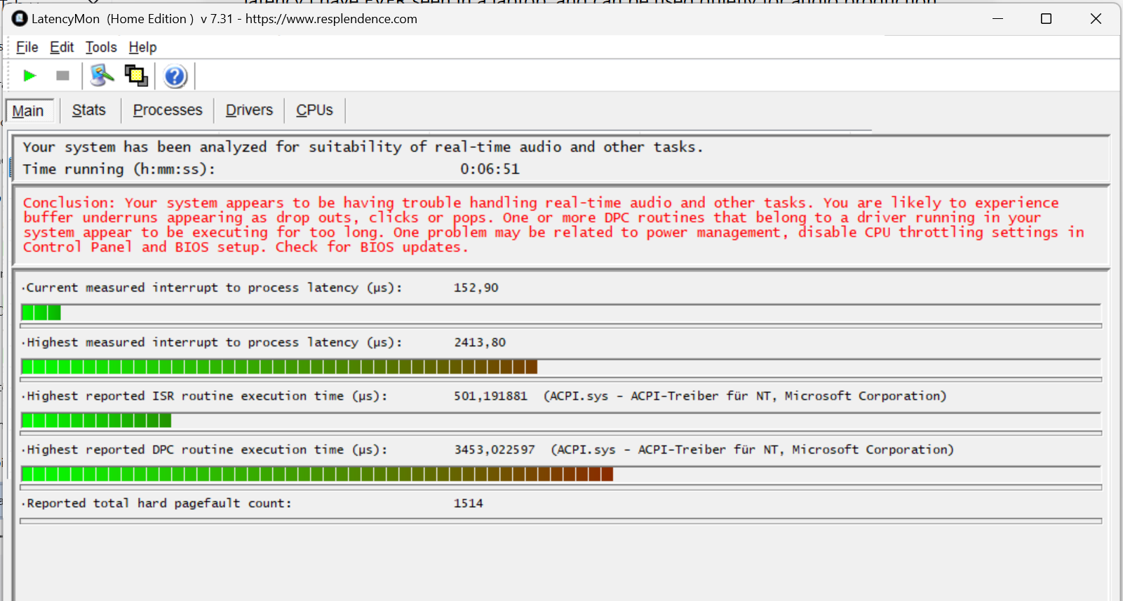

Hi, I’ve tried troubleshooting with LatencyMon. Here you can see the results:
Hardware:
  • Framework 13 - Intel 13. Gen - i7-1360P
  • Windows 11 Pro 23H2
  • Charging via AC Power during test
  • Connected to Wifi
The biggest source of “hickups” seems to be from ACPI.sys.
As far as I can tell from the different articles I found, this seems to be dependent on the drivers of the notebook manufacturer. [1]
In this case: the framework team.
I’ve tried tweaking the core affinities of the different drivers and processes.[2] With that I got the max interrupt to process latency down to somewhere 1400 µs - which is better, but still way to much.
Disabling Wifi reduced it even further, I got it down to somehwere 800 µs. This is closer to good enough, but still not ok:
  1. My Audio Interface still cracks and pops during playback
  2. I paid for a laptop with wifi and need it (e.g. streaming)
This probably needs some further investigation by some of people writing/maintaining the drivers at Framework and/or Microsoft.
Thankful for everyone patiently trying to follow.
