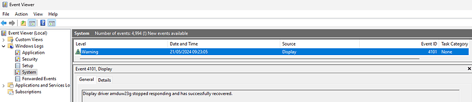

Is anyone else seeing
Display driver amduw23g stopped responding and has successfully recovered.
in their System logs in Event Viewer on Windows 11 right after booting the computer? I was wondering why my screen was black for a long time (about 30-60 seconds) after booting Windows, so I checked Event Viewer, and apparently it’s the AMD drivers.
I have the official Framework driver bundle installed, driver version 23.40.18.02 (also shown as 31.0.24018.2001 in the Device Manager, but the AMD software shows driver version 23.40.18.02).

Thanks for your reply! I updated my firmware yesterday and have not yet experienced any more crashes (I use a WD Black sn850). I will update you in a week or so if this solved my problem as well. :slight_smile:
Yes, I’ve been getting this when resuming from sleep.
Running the latest version of the AMD graphics drivers on Windows 11.

Hi, I just got my Framework 13 AMD 7840u. Got it up and running following the directions provided. Question… can I go directly to https://www.amd.com/en/support/download/drivers.html and download the AMD Software Installer? Or I have to stick with the software bundle I got from Framework as part of the installation instructions?
There are more than just the AMD drivers in the driver bundle so it should be installed first once you have installed Windows.
It would be a lot of work to separately find all the other drivers.
Once you have done that, if you’re feeling brave, you can try to find newer versions of any drivers that you feel you want to try the very latest version of.
