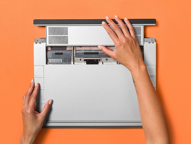

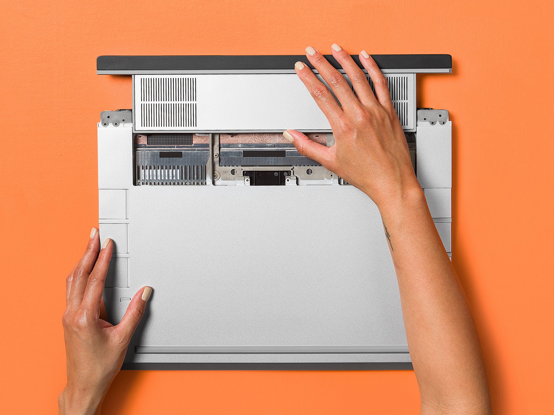

  1. Lets revisit disconnecting the GPU/Expansion bay (idk if you have a GPU)
Remove the keyboard, open up the black door at the top/middle of the midplate, unscrew the 4 interposer screws, and pull of the interposer (may be only 3 screws)
