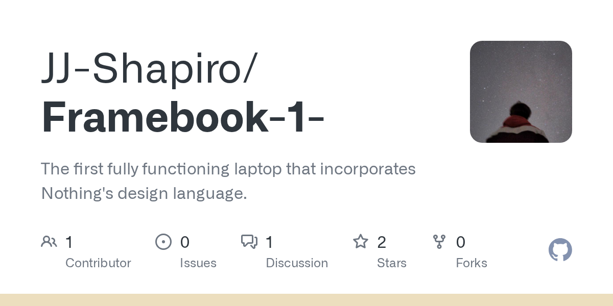

Not sure if it will be in the slightest bit useful to you, but I designed an alternative chassis for the FW16 including expansion bay slots and screw holes a while ago. I’ve never tested it, and it may not be quite what you’re looking for, but feel free to borrow/use/experiment with as much of it as you like, (and let me know if you find any issues🙃)
