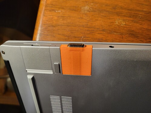

This is awesome! Here are my shots… I used the Sculpteo service, $20 total for two prints:
Material: SLS (Plastic), Nylon PA12 100-120µ (White)
Finish: Dyed, Orange
The parts fit perfectly, the bottom isn’t totally flat but no big deal for me.
