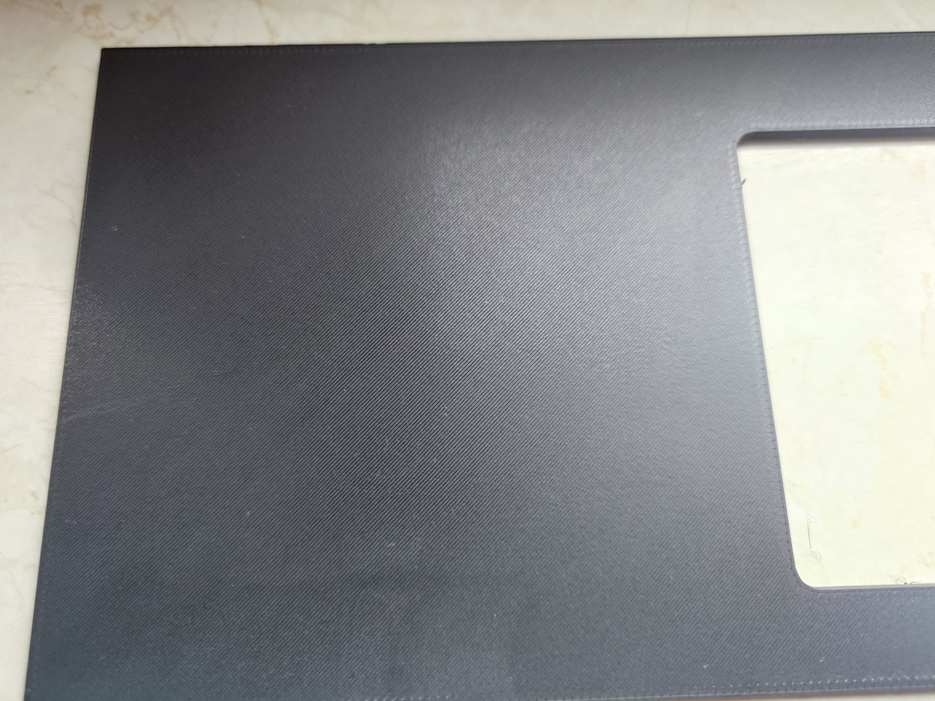

Here are some photos of the palm rest FDM PETG print I got from this person.
You can see the lines if you look closely, but I wouldn’t say they are unpleasant. And in the pictures they have in the linked topic, lines are not visible, so it may be that choosing a different textured plate would also hide the lines.
Don’t you also feel that texture when your palm is resting on it?
This looks like it is slightly underextruded/too high but still looks pretty good.
Not at all, I made the photos under sunlight so that the contrast is pretty high. In fact in dimmer lighting I can’t see the lines.
And the surface is completely flat, no rough texture, in fact it has a very pleasant matte texture
