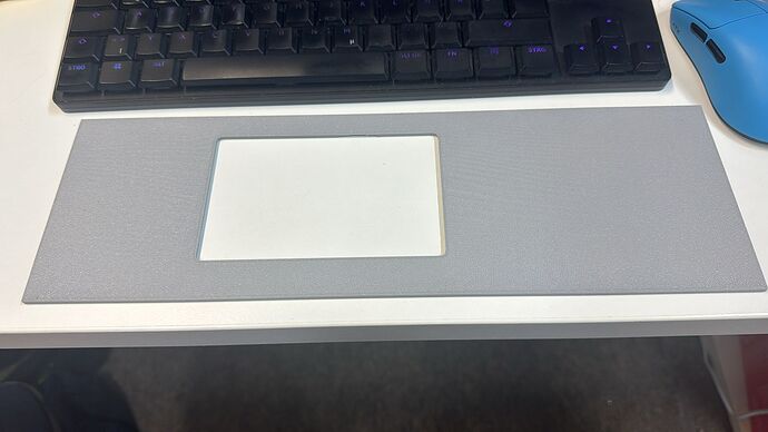

I will print in in 1 hour and send some pictures
Still printing but quality is bad. I was in a hurry and it’s the wrong temperature.
Update: it looks a bit better now.
Update 2:
It finished printing. I only have the frosted PEI plate.
I think I need a smooth one so it feels better (for me).
Nice, thanks for the pictures!
Here is the final result
The rough surface feels strange but still better than the spacers. It’s very tight but good.
You have to pay attention to the screws.

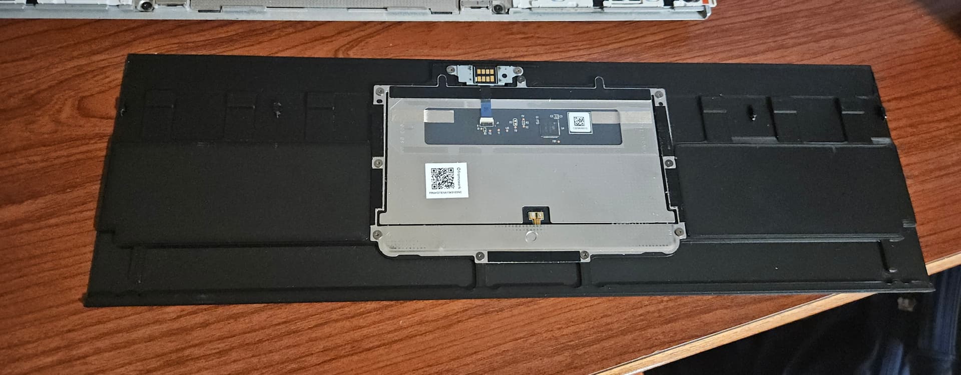

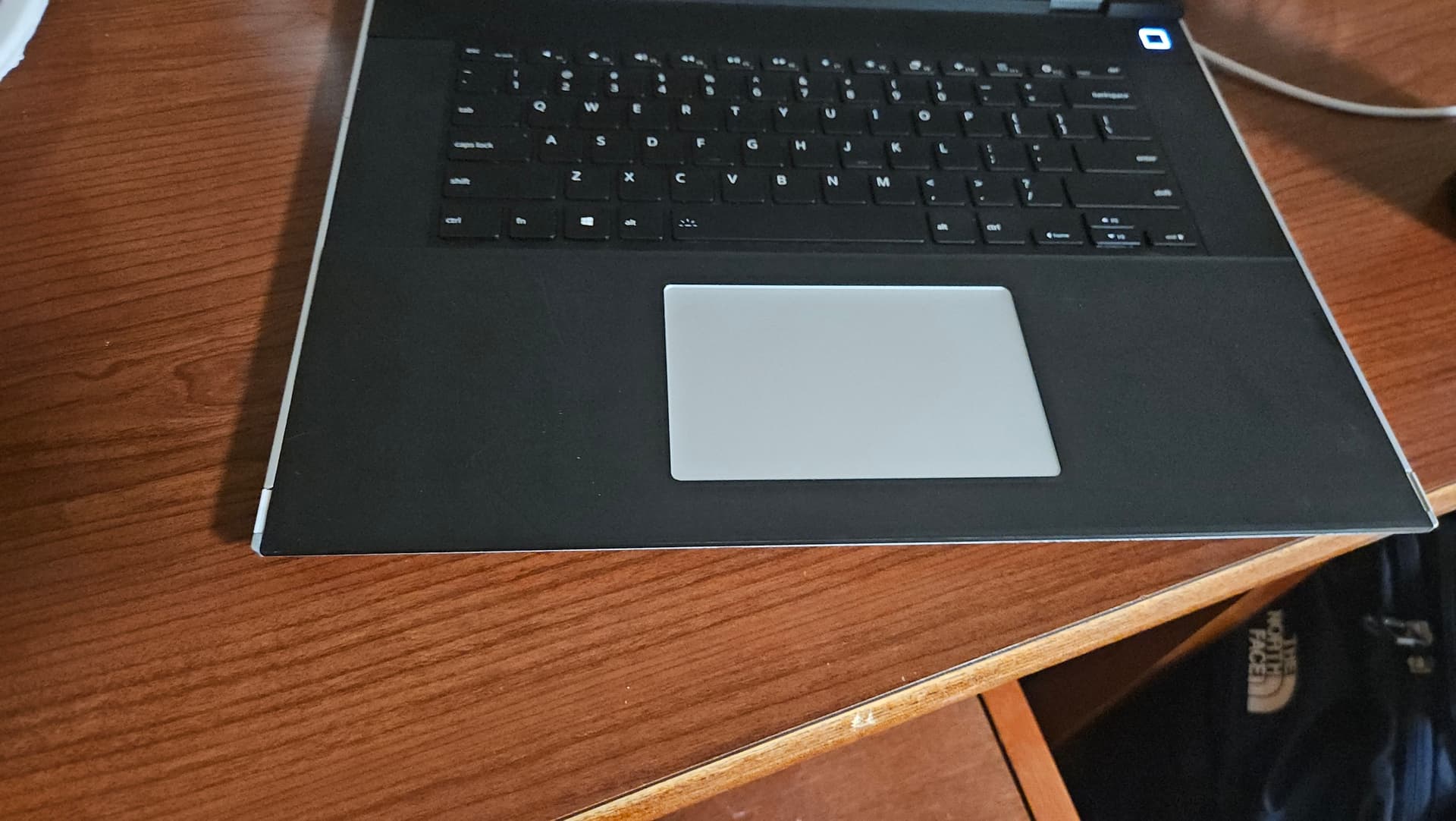

I’ve just 3D printed a full-width palmrest as well, in black PLA on a Prusa XL with the smooth satin bed. It’s the perfect size for the print bed, 10mm more and it’d be too long (at least when oriented orthogonally). I tried printing it in Prusa’s black polycarbonate blend, but admittedly I have no enclosure and little experience with PC so that ended poorly. If the PLA warps I’ll do more research and get the PC to work.
Pictures below:
It turned out great. Unless you look closely it’s difficult to tell that it’s any different from the black keyboard and spacers. Now I just need a trackpad skin and it’ll be perfect.
