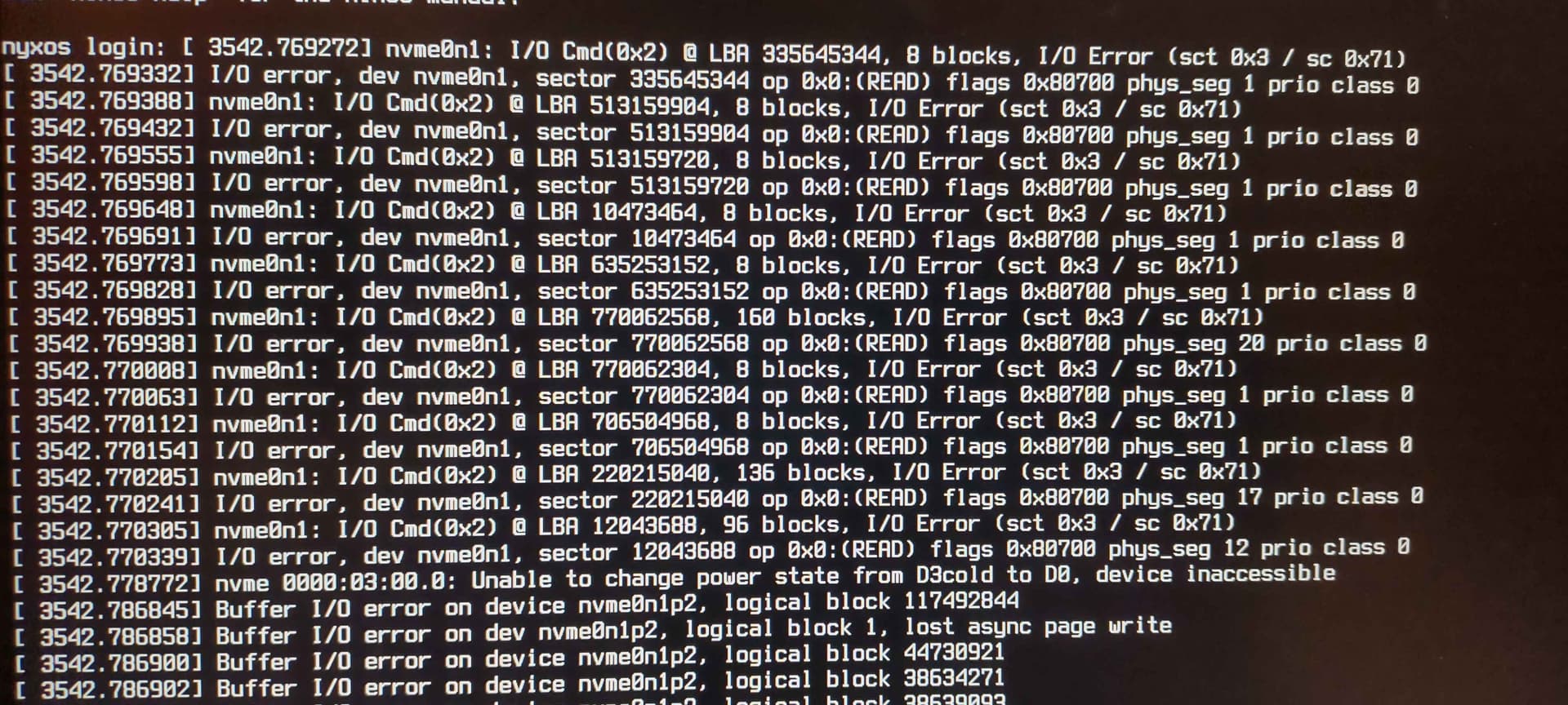

The FW will randomly decide to freeze/crash. Sometimes it happens right after waking up from sleep, and other times it just happens when I’m watching youtube. When it crashes the programs begin to become unresponsive, including the desktop (KDE Plasma 6) until it reaches a black screen. Sometimes I can switch into TTY mode, and sometimes I can’t. Even in TTY mode if I tried to log in, it’d freeze and go to a black screen with the cursor blinking in the top left corner.
It was really hard to get any useful debugging info as most of the times this is what was displayed in TTY
I finally was lucky enough to get error messages with meaning:
nvme0 refers to the Samsung SSD.
Most of the time nothing of interest pops up in dmesg while everything is working, but I was lucky enough to get this set of messages one time while gaming:

[ 1664.558723] nvme nvme0: controller is down; will reset: CSTS=0xffffffff, PCI_STATUS=0x10
[ 1664.558735] nvme nvme0: Does your device have a faulty power saving mode enabled?
[ 1664.558739] nvme nvme0: Try “nvme_core.default_ps_max_latency_us=0 pcie_aspm=off pcie_port_pm=off” and report a bug
[ 1664.592253] nvme 0000:03:00.0: enabling device (0000 → 0002)
[ 1664.594492] nvme nvme0: D3 entry latency set to 8 seconds
[ 1664.611686] nvme nvme0: 16/0/0 default/read/poll queues

So I am assuming something is up with power management, SSDs, and the FW16.
Ever since an update in like September I have been having issue with power management. With powertop enabled I was having issues the keyboard repeating keys frequently, and USB-A mouse disconnecting, and KDE Plasma was no longer able to communicate with powertop (improper power mode). So I disabled it by doing:
powerManagement.powertop.enable = false;
services.power-profiles-daemon.enable = false;
By doing that I believe it defaults to TLP.
I can revert to a flake.lock from August and the issues seem to go away. Which is not ideal and prevents me from updating. The issues seem to also be kernel independent.
