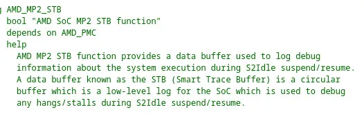

This is a known AMD issue. It so well known that AMD is actually attempting to solve it by creating debugging methods for the Linux Kernel.
With the ethernet card plugged in, please can you do:
lspci -vn
and post the output. I can then see which part of the kernel source code has the bug.
It sounds like a kernel suspend bug in the ethernet driver or thunderbolt to me.
Its good that you have narrowed it down to the ethernet card.
I guess the next step is to see if any other FW16 people can do the same test you did with the ethernet card to reproduce the problem.
There would then be workarounds you might be able to use.
e.g. manually do “rmmod drivername” before you suspend and “modprobe drivername” if you wish to use the ethernet card again.
Also, it might save a bit of battery power for you also.
